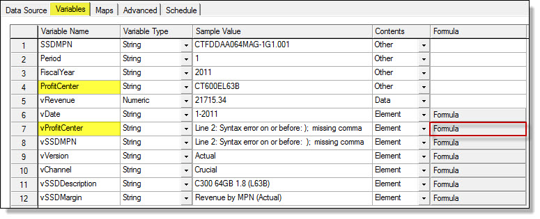

In regards to number 2 below... light bulb just went off! We are a very heavy user of Cognos Analyst, which is 32-bit and it is very engrained in me to just ping .csv's (which we pull from SAP) and then just use SQL to filter out what we don't need (or what we need) so end users don't have to manipulate the files that are pulled from SAP. It's such a commonplace as we have around 100 ODBC DSN's that are either using Microsoft Excel Driver or Microsoft Text Driver. Those 100 DSN's ping around 500 load files. But, Analyst is 32-bit. We have played around with uploading .csv to a SQL server but that adds complexity and (IMO) an unncessary layer. So, it's been a struggle, but I hadn't thought of just using "Text" data source and then creating a variable and then using code there! It's not as easy as just writing one SQL syntax statement, however, it's better than addding the complexity of publishing to a SQL server.
I had not thought of that so I really appreciate that!
So, with that in mind, one of the columns I pull in is "Profit Center" and so on the variables tab I called it "ProfitCenter" and then created a variable and called it "vProfitCenter" in which I tried this code:
But it's telling me "Line 2: Syntax error on or before: SUBST (ProfitCenter, logicial expression
In looking at the developer's guide, it appears that I have it correct and then using what you gave me
Any ideas on that? I know this strays away from my original post but your input on this specific certainly provides hope and a ray of sunshine on accomplishign what I want without adding the complexity. Thanks again!
vProfitCenter=
If(SUBST (ProfitCenter,6,1) <> 'A';
ItemSkip;
EndIf;In looking at the developer's guide, it appears that I have it correct and then using what you gave me

vProfitCenter=
If(SUBST (ProfitCenter,6,1) @<> 'A';
ItemSkip:
EndIf;
ItemSkip:
EndIf;

Ha! Macsir.... I was just re-reading and saw that...
And was just trying it when I got notified you posted.. haha.
I changed it to:
But, still an error
"Line 2: Syntax error on or before: ; missing comma
Thanks!
I changed it to:
vProfitCenter=
ItemSkip;
EndIf;Thanks!

vProfitCenter=
If(SUBST (ProfitCenter,6,1) @<> 'A');
ItemSkip;
EndIf;
My bad, I didn't notice it either.
ItemSkip;
EndIf;

Thanks again!! Whew... I didn't catch that last closing parenthesis either
But, unfortunately, still not working (totally siderailing the original topic, but again... this is going in a new direction that I hadn't thought of and will at least alleviate a little pain, although it does have a learning curve for me).

Correct. I was trying to do this on the Variables tab. When I pull in my data from the .csv file, it has a column called "Profit Ctr" and then on the Variables tab, I renamed it to "ProfitCenter" - so the one that is "ProfitCenter" is my original data. The one that is "vProfitCenter" is the one with the forumula that points to the original "ProfitCenter."
I'd actually really like to do it on the Variables tab (for different reasons). I write SQL against .csv's a TON in our Analyst models so I would like to stay similar to that. But also, to clarify, in my .csv, it has all profit centers... but when I pull in my data into TM1, I want all profit centers BUT the ones where it has an "A" as the sixth character. Otherwise, I want the full 10 digit profit center - just not the ones where "A" is the sixth digit.
So, in the screenshot below, the code that is in the "Forumula" (one outlined in red) is:
Again, greatly appreciate your help!
vProfitCenter=
If(SUBST(ProfitCenter,6,1) @<> 'A');
ItemSkip;
EndIf;
- ProfitCenterExample.jpg (105.33 KiB) Viewed 18898 times

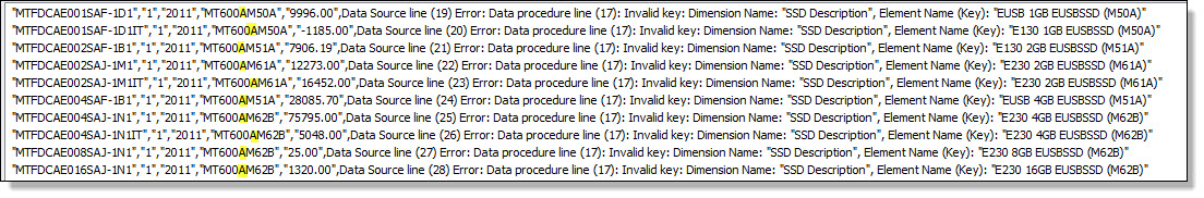

Hmmm. Maybe I see why you want to do it in your Advanced tabs? I ran the process but I got an error box versus 'completed successfully' and it's showing the ones I am trying to exclude... I don't like end users to get this error box on a regular basis because then they get immune to it and when there truly is an error, then they ignore it. Do you guys agree? (Sorry if this seems to basic to you - definitely still learning and I appreciate your patience!)
- ErrorExample.jpg (168.25 KiB) Viewed 18895 times
