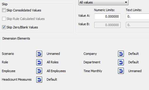

I wonder if anyone knows why my TM1 server falls over in a heap if I try to "Export as Text" as shown below:-
The amount of data returned by this view is very small being a summary of just 3 measures for each fiancial year. It works fine if I export data at leaf level but crashes as soon as I try to export consolidated values.
I am running v9.5.20200.22178.
Thanks for your help.
AmbPin
Posts: 173
Version: 9.5.2
Excel Version: 2007-10
Re: Consolidated values makes "Export as Text" Crash Server
Post by AmbPin »
Hmm,
Seems it may be a "feature" of that particular build. I just applied FP3 on a test server and it works fine now. I wonder what treats lie in store with FP3?
