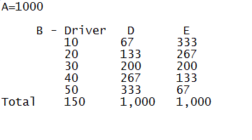

Hello forum,
I've an allocation problem which at first glance ought to be easy to solve but has me stumped.
A standard allocation is easy, the largest item gets the most of the cost and so on.
A= Amount you want to allocate.
B= Amount of the allocation driver that is on the cost centre.
C= Total of the allocation driver that is on all cost centres.
D= A * (B/C)

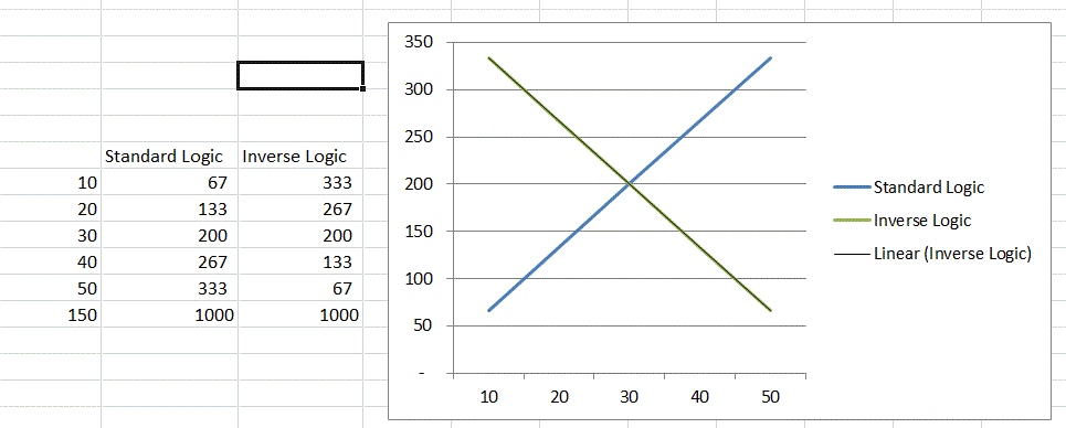

What I want to do is allocate so that the smallest B gets the largest amount, i.e. column E (or close) in the table below. I've tried a few ways involving reciprocals that kind of do it, but give a curve if I graph the allocation, this isn't right since each unit of the driver ought to have the same weight.
I (probably) could also do it with a TI by calculating D, ranking the result (a non-trivial exercise) and then applying the result to the "opposite" ranked item.
I'm really looking for a mathmatical method that I can use in rules but can't seem to figure one out, not sure if I'm missing something obvious...
Anyone done this before or have any ideas?

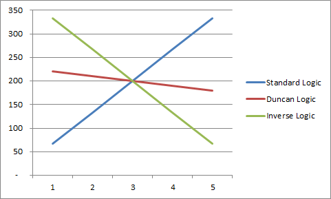

Thanks Duncan, This does give a straight line but isn't I think the opposite of a standard allocation.
Possibly I've applied your logic wrong but if I graph the result I don't get what I was expecting (grren line)
(I've added a GIF for the table in the first post, I hadn't noticed the format had been lost on posting.)

You might like to look at creating a new driver. You could do this in a number of ways.
The easiest is
Another is

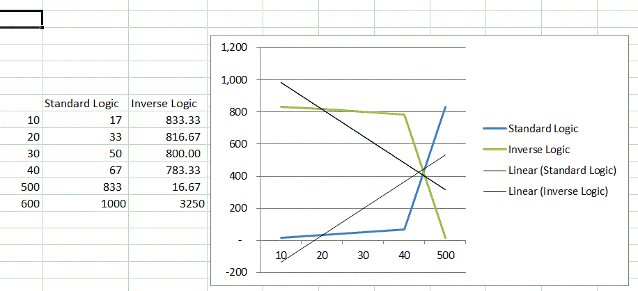

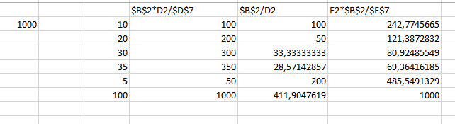

I've had to do this before and it was a bit of a nightmare. I managed to use the following logic. It's not perfect but it was close enough for the project I was working on and saved a lot of extra complexity / processing power to implement.
May not be accurate enough for your requirements but might give the basic shape you're looking for.

The problem appears to be to choose a way of generating a new driver that has an ordering that is the reverse of the ordering of the original driver.
Garry's example shows another way of doing this using the reciprocal of the normalised driver. The key question is which way is appropriate for the actual allocation being done.
For both Garry's and Steve's situations it would be really helpful to know what was being allocated, and across what, and what the driver was.

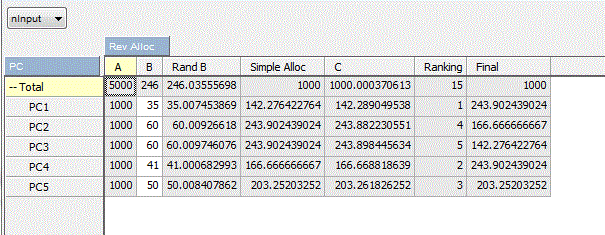

Right,
I think I have a solution which works now.
It uses the dummy dimension to perform the ranking by repeating the value the number of times equal to the ranking. Then a ranking can be built on the fly by dividing the total of the ranking column by the original allocated value.
The ranking is then assigned as an alias to the elements and is used to return the reverse ordering of the values.
It works in every case, EXCEPT if 2 drivers are identical as the alias fails. It should be possible to get round this using the dummy dimension in the cube to apply a mask based on the ranking logic, but then how should it work logically if this were the case anyhow?
If the first 2 drivers are the same, does column E show the last 2 allocated values the same?

# else
0
# Use Ranking alias to look up reverse ranking amount
['nInput', 'Final'] = N:
DB('Rev Alloc','nInput',
STR(ElcompN('PC', 'Total') - ['Ranking'] + 1, 3, 0),'C');
- Rev Alloc.zip
- (2.35 KiB) Downloaded 537 times
whitej_d
- Posts: 103
- Joined: Mon Sep 05, 2011 11:04 pm
- Version: 10.2
Re: Reverse Allocation
Actually if you need to cope with duplicate driver values and still apply the reverse allocation, you can add a very small random number on the the driver and calculate the ranking based on this unique value.
Duncan P
- Posts: 600
- Version: 9.5.2 10.1 10.2
- Excel Version: 2003 2007
- Location: York, UK
I would be quite careful in using random numbers in TM1 rules and TI as RAND can only return 65536 distinct numbers before it starts repeating itself.
Probably not an issue in this case but something to be aware of.
whitej_d
- Posts: 103
- Version: 10.2
Fair point!
You could instead use the (dimix('PC', !PC)/ 100000000000) to make it truly unique.

- Steve Rowe
- Posts: 2467
Many thanks to all for your efforts, I'm beginning to think that the problem is impossible but I'm struggling to understand why....
whitej_d especially thanks for building a working model based on ranking however thinking about it further however I don't think a rank based approach will work since it assumes an even spacing of the initial values that are driving the allocation. Irrespective of the practical aspect of doing the work on many thousands of data points any solution should result in each point of driver attracting the same value of the amount to be allocated.
ioscat, I think your logic fails for the same reason, each point of the driver number does not attract the same amount of the cost.
Garry, thanks for your suggestion, I'd already been down the reciprocal route but again the average cost of each point of the driver is not the same using this method.
I have fiddled around a bit more and plotting the trend line of the standard chart with it's formula gave me a clue on how to do this. It is still by no means straight forward (in TM1) but I think gives the right answer.
If I calculate the average point cost against the whole range I get the following (using the same example)
AvPtCnt=1000/150=6.67
I then need the max and min of the driver number (the hard bit in TM1) and multiple this by the AvPtCnt
MaxPts=50*6.67=333.33
MinPts=10*6.67=66.67
Adding them together gives me 400
My reverse allocation formula is then
RevAlloc = -AvPtCnt*Driver +MaxPts+MinPts
Putting this into Excel gives me the same shaped graph.
This appears to hold for the general case too.
So this seems OK to do I only need to do "rank" the highest and lowest values of the set of driver values which I think I would probably do in a single pass through them with a TI job, not ideal but hey ho...
To me this seems like as close as I am going to get to a perfect solution anyone have a better idea?
The actual business problem is as follows.
A bunch of individuals under take a series of jobs, depending on certain properties of these jobs (time of day, day of week, the customer account the job is undertaken for) each job gets a certain number of points. These points control how much the individual is paid for the job which decreases the profitability of the job for the business so when we calculate the profitability of the customer account we need to do a reverse allocation.
Cheers and thanks to all for the efforts, hope y'all enjoyed thinking about it....
Cheers,

- Steve Rowe
- Posts: 2467
Hmmm, Should have checked out Duncans piece about creating a new driver too as this works as well
option 1 also works I'll need to think about if it is a more efficent method.
Cheers,
I suspect his option 2 is the broadly the same as my solution and involves the same level of effort since I need to know the min and max of the driver value.
new_driver = 2 * mean( driver ) - driver
new_driver = min( driver ) + max( driver ) - driver
Cheers,
