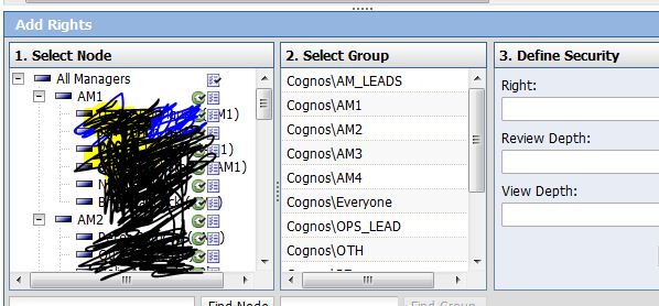

Prior to this, I wasn't able to see the manually-added groups I created in the Select Group in Performance Modeler when I tried to manage the Rights for my application. (See image)
I noticed that the principal element name convention in TM1 }Groups dimension is CAMID(":<Group Name>"), and a attibute value format for }TM1_DefaultDisplayValue of Cognos\<Group Name>.
I followed the existing formats and was able to see the groups in the selection pane. I did the formatting in TI.

Performance Modeler
Performance Modeler
