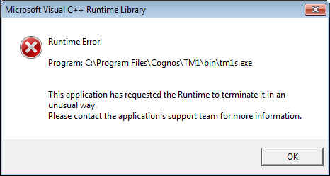

When i double click on the cube in order to open the cube viewer I see a runtime error message.
Is possible tune something in order to avoid the error message? Is the problem due to a memory issue?

Alan Kirk wrote:If you're getting an error, please be specific about what the error is (full details, not just "a runtime error" or "process terminated with errors"), and the circumstances under which it's occurring
Hi Alan,
the error is that showed is in the attached image (I read some past posts in this forum about it)
But I don't care about the error because I'm performing some tests.
Above all, I'm interested to the cause of the problem. 8Gb of RAM might be the problem if each of two dimensions of my cube include 200 millions of element?
If yes, I can't use this cube in TM1 (I must use a solution based on Transfomer) or I must increment the memory of the server.
Thanks very much for your time

From the error screenshot you supplied it would seem that yes the 8GB of RAM on the server is inadequate, probably woefully. But dimensions, even huge dimensions, shouldn't be taking up too much of the total amount of memory, it is the cube data and retrieval performance that you should be really concerned about with having such large dimensions. But the cause of your immediate issue could be (or probably is) related to simply trying to browse one of these massive dimensions in the subset editor and that is what is causing the memory spike and termination of the application. The Subset Editor GUI quite frankly just wasn't written to handle browsing very, very large dimensions and it doesn't cache in an efficient way.
I have this error when I try to open the cube viewer.
