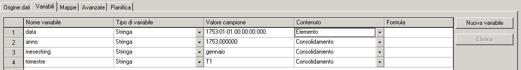

I attached 3 jpegs showing my process configuration.
In the 1st image I set Data as Element and others Year, Month, Quarter (corresponding to "anno", "mesestring" and "trimestre") as consolidation
In the 2nd image I set the name of my dimension

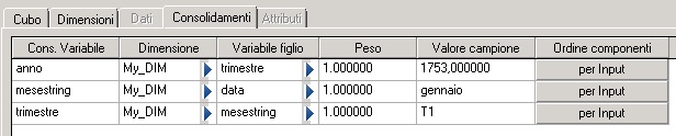

In the 3rd image I setup the hierarchy indicating the children elements
This same image shows the results of the dimension
As you can see, data are not in the desired hierarchy
What's wrong?
Thanks in advance for your help
Re: Dimension with multiple levels hierarchy
What about the Consolidamento tab? Whats's the code on that one?
Your dimension is being built exactly as you have specified in the Consolidations tab. I can't help you correcting it because I can't read or write (Italian????) so I don't know what the correct designation of the variables should be.

AnthonyT
Posts: 42
Joined: Mon May 19, 2008 10:25 am
OLAP Product: TM1, EV
Version: 9.0 9.1 9.4 9.5 10.1 10.2
Excel Version: 2003 2007 2010 2015
Location: London, UK
Post by AnthonyT »
Hi Roasanero
Not sure if this is the problem, as my grasp of Italian doesn't much go past the names of football teams!
It looks like the consolidations are not unique so get rolled up into multiple places!
For example, October is not unique to 2012 - there is one in 2011, 2010 etc. The same for weeks as well - week 01 is not unique to January 2012 as there is one in January 2011..... you get the point!
By creating new variables you could join together the year and month to get 2012_10 or 2012_October, and the same for the weeks - 2012_October_Week01. Weeks then role up into Months, which role up into Years.
Hope this helps
Anthony
That's no moon - that's a space station
Post by Rosanero4Ever »
Hi Anthony,
I was suspecting just that you wrote.
But this isn't a pretty solution (even if I think is THE solution), aren't you agree? ;)
I used Transformer and the dimensional functionalities of Framework Manager and there all is more simple and hierachies are created in a few minutes.
So, I'll adopt this workaround... ;)

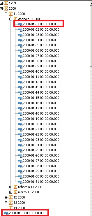

now it works (see the attached picture), but why dates are also outside the consolidation?
Duncan P
Posts: 600
Version: 9.5.2 10.1 10.2
Location: York, UK
Post by Duncan P »
This could be just a display order issue. Press the "Hierarchy Sort" button in the subset editor to see if the problem goes away.
If it does and you want to fix it permanently you need to press the "Ordine componenti" button on the "Dimensioni" tab and select the Italian equivalent of "Automatic" and "Hierarchy" in the dialog.

Rosanero4Ever
Posts: 54
Joined: Thu Oct 18, 2012 5:08 pm
Version: 10.1.1
Location: Italy
Right!
Thank you
