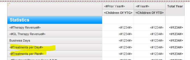

I am also working on a report to show last 12 Months data from selected Month and Year with a TM1 Cube. I have separate Year & Month dimension and i am creating this report in cognos report studio. i have to show multiple measures in rows and last 12 months in columns.my approach ro get this is as follows
I created 2 value Prompts for year and Month and then calculated Prior year with IF ..THEN ..ElSE with year prompt(if ?year? = 2010 then ..)
calculated Month YTD and Month YTG in same way by using ?Month? Prompt.And Total of last 12 months as Tuple (Current measure,Prior Year, Month YTG)+Tuple(current measure,year,Month YTD). it is working fine for totals. but there are 2 measures in rows where it default shows average. my caclulation for TOtal is not working in this place as instead of x/12 it is calculating as a/months in prior year+b/months in year.
can any one tell me if there is an alternate way to get last 12 months in report.
