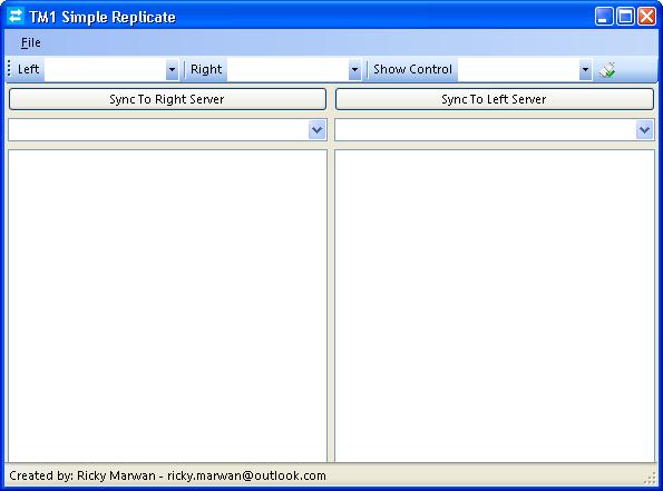

Replicate cubes, rules and other TM1 Objects from development to production?
Tested with TM1 9.4.1 and 10.1.
Read ReadMe.txt for installation instruction

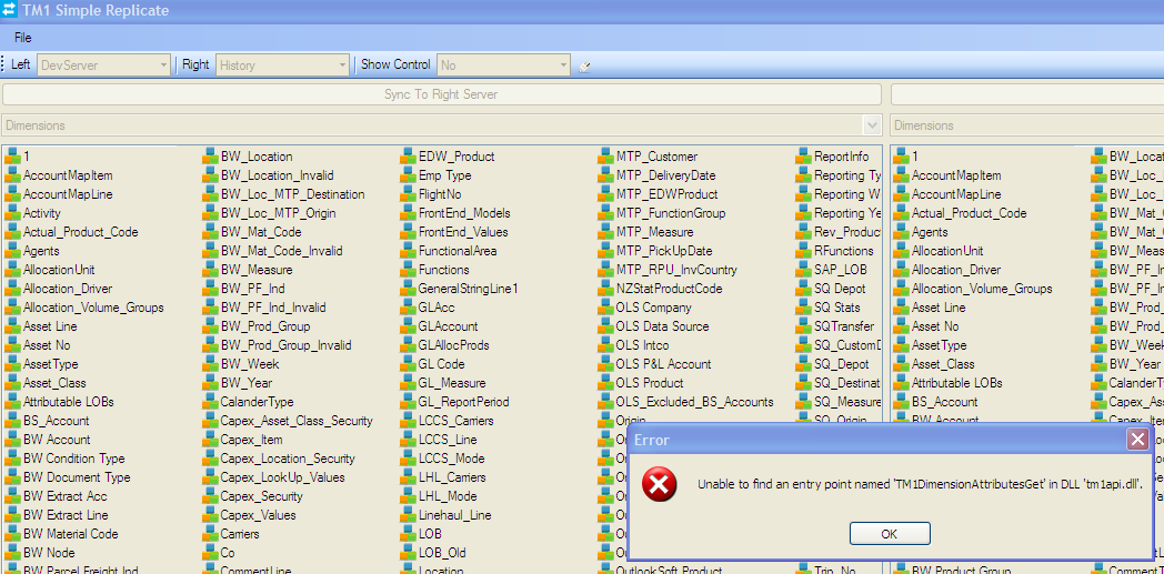

Hi Ricky,
I just had a chance to test this promising application for promotion between servers.
I have some success in moving objects around but I stumped on this particular error several times.
( see attachment).
I believe I have set up everything as indicated in the text file.
Any idea why this occur ?
Thank you,
Kind Regards,
Olivier
( see attachment).
Thank you,
Kind Regards,
Olivier
- Error message.png (72.56 KiB) Viewed 62195 times

Hi Olivier,
Which TM1 version you use?
You may check tm1api.h for function
TM1DimensionAttributesGet( TM1P hPool, TM1V hDimension );
It shouldn't be a problem if function exists, did a test with TM1 version 9.4, 9.5.2 and 10.1

Hi Ricky,
Thanks for the feedback.
I checked the function and it was not there in my tm1api.h file.
The 9.4MR1 client I was testing with was not updated with FP3 / HF12...
I checked again after updating the client and the function is now referenced.
I will do some more tests on promotions and post if any issue.
Thanks again.
