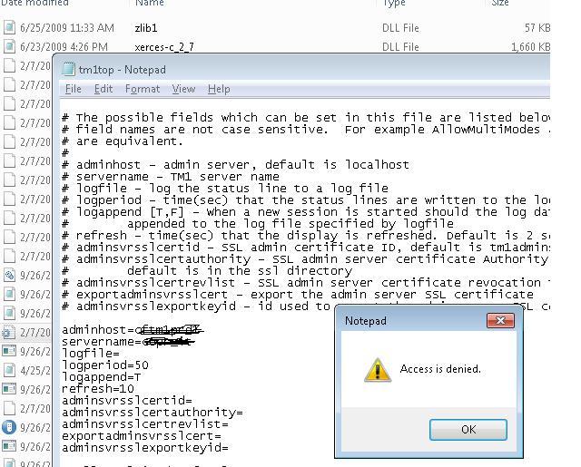

I have to monitor some jobs through tm1top (952 ver).
having some issues -when i log into tm1top after configuration
please advise.

The screen shot you are showing has an "Access Denied" being generated by Notepad, presumably when trying to save changes to the TM1TOP initialisation file. Have you checked things like read-only flags and file permissions for that file relative to the user doing the editing.
Re: TM1top issue
If you are going to edit the tm1top config file on Windows Server 2008 you will need to run Notepad as an Administrator (right click on Notepad and choose Run As Administrator) in order to be able to save the config changes.
Re: TM1top issue
tomok wrote:If you are going to edit the tm1top config file on Windows Server 2008 you will need to run Notepad as an Administrator (right click on Notepad and choose Run As Administrator) in order to be able to save the config changes.
Or you can copy the tm1top.exe together with the ini file, the DLLs and the SSL folder out of C:\Program Files to somewhere that the user has default write access to and then there should be no problem. You would need to do this anyway in order to be able to set up multiple top sessions to monitor multiple servers (or use cubespy or vizier to monitor multiple servers but both cost $$).
Ravi - it's unrelated to your issue which as has been pointed out is nothing to do with top or TM1 but rather windows permissions, but your actual settings for log period and refresh look strange. Refresh every 10 sec and log every 50? If there are queue and lock issues chances are you won't see most of them.
