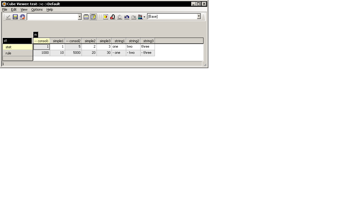

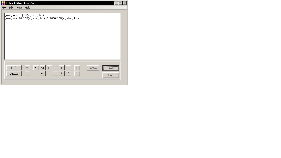

I am running version 9.5.2 and with the following rule
I get this behaviour
Is this the kind of behaviour you are after?
EDIT BTW I made the three parts of the rule different to be able to distinguish the behaviour in the view.
