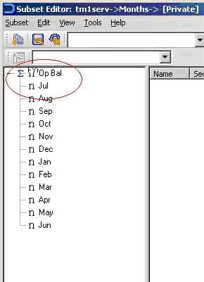

Screenshot
Screenshot
Everytime I open a cube in TM1 and select an element (such as “Months”) it looks like the above snap shot. If I then click on OK to select one of the elements, it then crashes my whole excel.

Sorry, I may have misread the original question; the .tbd file affects SubNM formulas, but re-reading your original post you meant that it's happening in Server Explorer itself?
If so, is it only happening when you open the subset editor in the Cube Viewer, or is it also happening when you open the subset editor directly from the Dimension list?
Is it happening on one particular cube view, or all of them?
(That may isolate whether it's an issue with the dim or the cube view.)

Byron Hsu wrote: Everytime I open a cube in TM1 and select an element (such as “Months”) it looks like the above snap shot. If I then click on OK to select one of the elements, it then crashes my whole excel.
Another throught about the screwy display there; are you using the most current display drivers? Are you on the Normal font size, or a large (120 points) size?
(Not that either of those should be causing Excel to crash, but it could explain the corrupt display.)

It is happening on all subset editors in TM1 Server explorer. I've also discovered one thing, if I select multiple elements and click "OK', Excel doesn't crash. But if I select one of elements and click "OK", it crashes the whole Excel. It seems the issue is not happening on the TM1 server itself, only happening on some of end user perspectives.

This bug has been around for donkeys, it's some weird combination of non-standard windows display settings (something to do with text-size?). Not that it doesn't happen if you work with the properties pane, it's good practice to work with the properties pane off anyway since it can have a performance impact.
Depending on what release of 9.1 you are on it's probably worth upgrading though.

NO NO NO NO there is an easy fix, we've had it here on a number of occasions.
The fault relates to the relationship of the window size with your desktop size. Don't know why it happens but the solution is straight forward. The issue is given away by the 1st 2 elements of any subset editor overlapping. All dims will do it because TM1 stores the last used window size in your profile. All you need to do is open the editor, resize the window to anything different, then click CANCEL on the editor. Hitting OK as you have found out will crash Excel. When you hit cancel it updates the last used window size, open the editor again and you'll find the 1st 2 elements look normal again and it'll work fine.
We have about 450 users spread over several TM1 instances here and i've probably seen it happen about 10 times in 2.5 years.

close tm1p.xla
set this value in your %appdata%\applix\tm1\tm1p.ini to blank:
SubsetWindowLayoutInfo = 12346578
start tm1p.xla
can also help

All I need to do is to resize the subset editor once and click "cancel", the problem goes away.
thanks a lot Steve Vincent, you are the legend. How did you figure that out?

Pure chance. It was reported to Applix at the time, nowt got done about it tho. Its so hard to reproduce i don't think they bothered to look at it. Probably get one call every 2/3 months about it now and the fix is so easy i can't see the point in raising it again.
