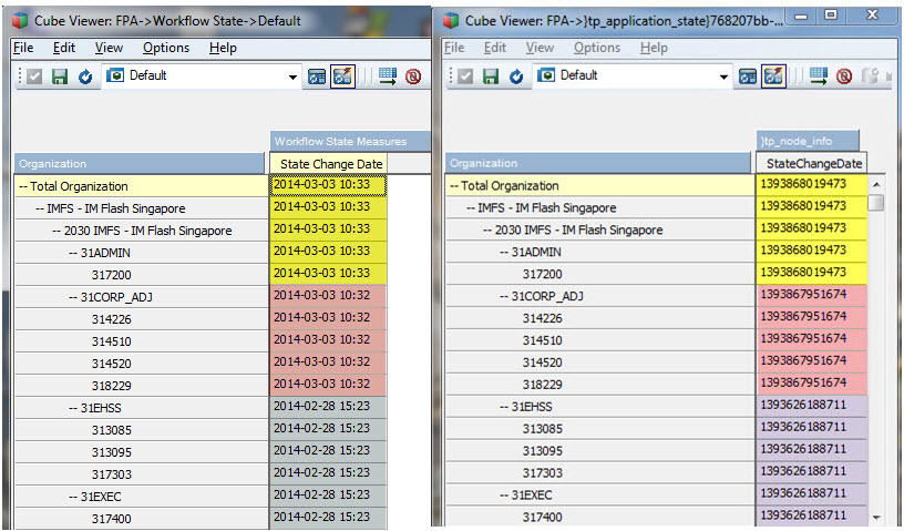

I was wondering if anyone had an issue with the last code in this thread? I am using it and it works (converts the date/time into something more user friendly), however, it's not doing it as expected.
Here is my exact code:
But, as you can see in the screenshots, in the original tp_application_state cube, you see three different "StateChangeDate" numbers (should all have the same date, however, different times), but when converted using the rule given, they are all the same.
Do I need to do something in addition to the code that was given? Or any ideas why they are all the same once converted? Thanks a lot!

I am just using the code that 'failurehappening' provided and simply replacing his 'tp' info with mine. It's working okay (converting) but like you said, it's repeating the same value for all items versus looking at each one individually and converting.
I am in need of a true conversion... meaning, the ones in yellow would be one date, the ones in red would be a different, and then the ones in purple would yet be another. Because, they truly are.
So, there must be something not quite right with that code and must need some slight tweaking. But, how to do that is where I am, unfortunately, stuck.
Thanks again to anyone!
JIM

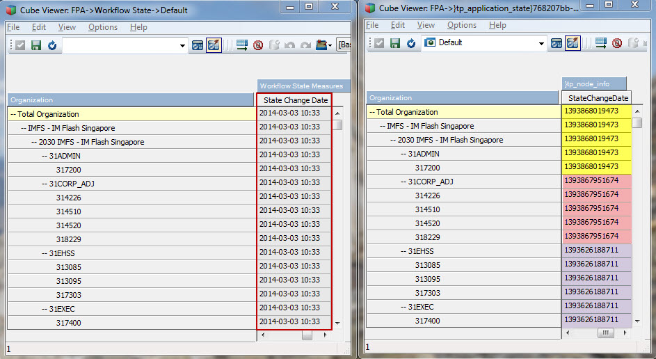

Ah HA!
That was the boost needed! Figured it out
I replaced that second part (that you called out) with the "Organization" name... saying, hey, apply this to all members of "Organization" by using the bang.
That worked!! Thank you as always!! Hopefully this additional info will help folks in the future that may look at this thread.
Here is a new screenshot showing how it's fixed:
['Workflow State Measures':'State Change Date'] = S:
IF (DB('}tp_application_state}768207bb-5acf-467c-9a1c-90b10807e8cf', !Organization, 'StateChangeDate') @='', '',
TIMST(((NUMBR(DB('}tp_application_state}768207bb-5acf-467c-9a1c-90b10807e8cf',
!Organization,'StateChangeDate'))/86400000)+3653+(-7/24)), '\Y-\m-\d \h:\i'));That worked!! Thank you as always!! Hopefully this additional info will help folks in the future that may look at this thread.
- Date Conversion Fixed.jpg (170.93 KiB) Viewed 14930 times

Thanks again Declanr! Awesome. It's working.
