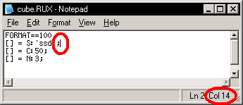

Yes it is. The rule for each cube is contained in a text file with a .RUX extension. If you load this in NOTEPAD and enable the status bar from the "View" menu it tells you the position of the cursor. If you put it on the end of the longest line it will tell you its length.
Like this
