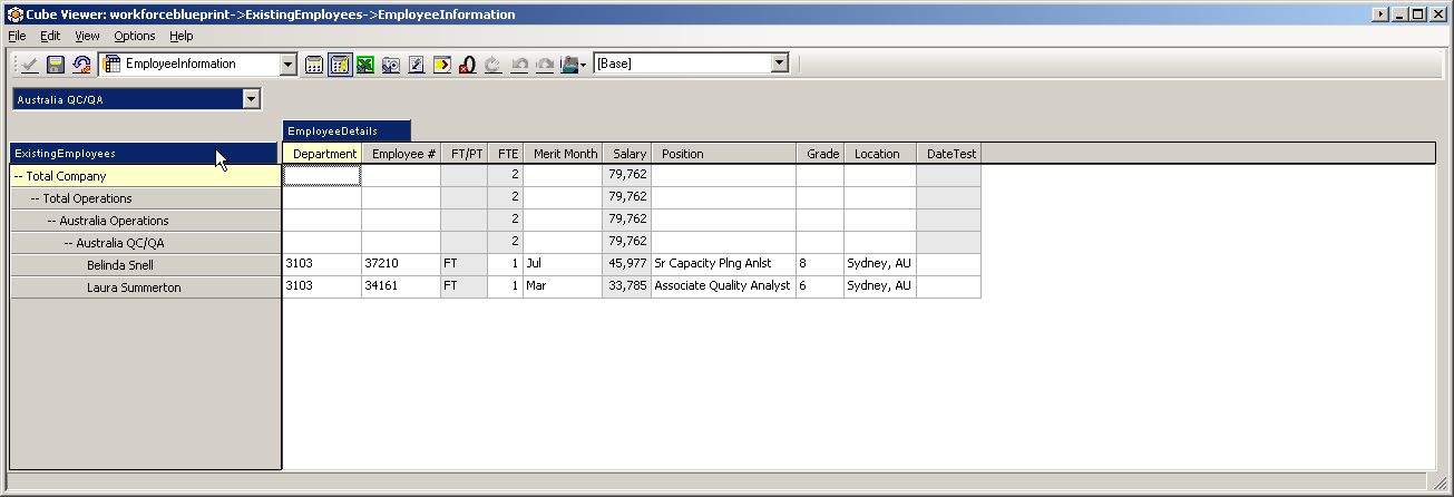

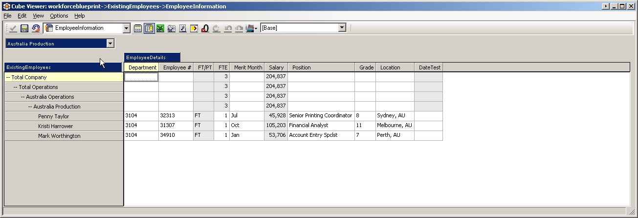

Hi Steve,
There is no zero suppression set in the view. this behaviour is also showing in perspectives (not just in contributor). I am aware that you can achieve this using MDX but there is not a subset set with MDX or filtering so I am curious if anyone else has seen this. see before and after screenshots of changing the title dimension.

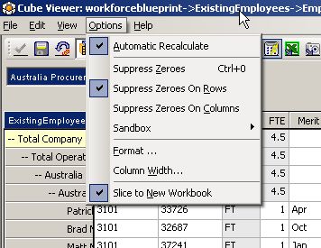

I believe QML solved it. There was a zero suppression set on Rows (i previously only looked at the toolbar which does not show row suppression so never picked up that there was zero suppression set). As for Tomok, I was thinking your aproach was what was being used but what threw me was that there were no rules for the cell security cube and the cube appeared to be empty.
In the end a relatively simple solution. Thanks for all the help!
