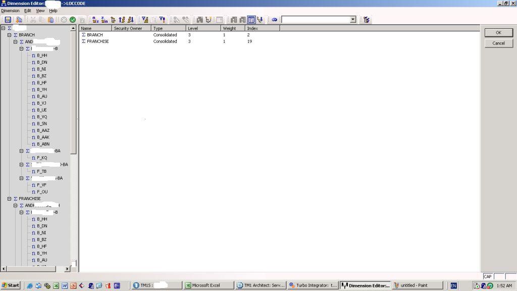

please find the attachment, i have an issue with the branch and franchise, the branch codes are repeating for franchise and franchise codes for branch as well.
I have changed by giving prefixes.

- HIERARCHY.jpg (46.02 KiB) Viewed 2622 times

If you could reply attaching the process (file with .PRO extension) that builds this dimension and the datasource from which it get the members it will be easier to see what the problem is. I am presuming by the way that this is a continuation of the "Filters in TM1" thread.

The repeating or circular loops may occur if the Data Source you are loading have repeating hierarchy.Until and unless you provide your data source or a sample source which is exactly similar to your source and your process file (.Pro) then i or any one can help you out.
