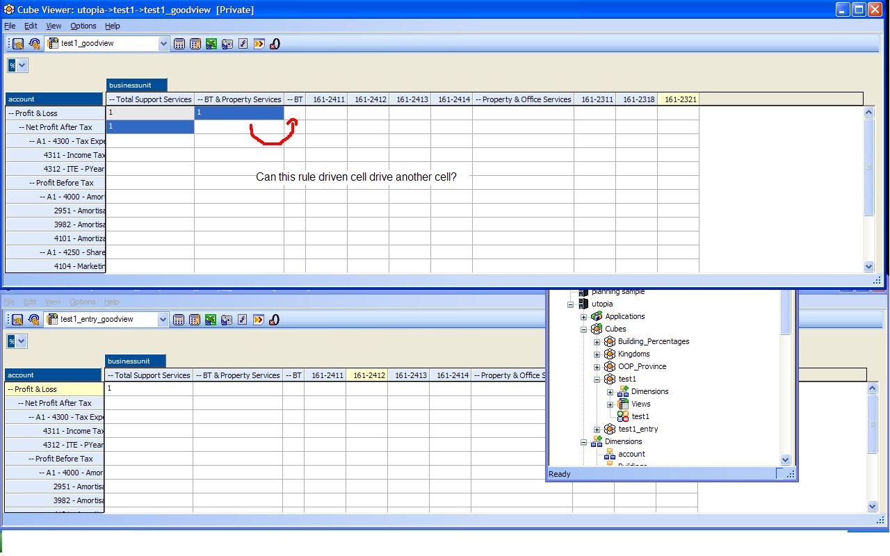

I want a rule for a cell A which depends on cell B, however cell B depends on cell C (Cell C has been entered manually and is not rule driven).
Is this possible?
How can I achieve this?
An example below:
In the first cube, the highlighted cells are calculated based on the top left cell (are set to be the same value of '1').
I now want other 'businessunit' dimension elements eg. BT to be calculated based on these highlighted cells.
I've tried it but it doesn't seem to work, it seems as if the cube doesnt know about its own calculated cells until after everything is done.
I was hoping there would be some kind of 'touch' function that would evaluate everything so that further rules could make use of already calculated cells.
Rules for cells based on rule based cells
- cubes.JPG (150.87 KiB) Viewed 6860 times
Re: Rules for cells based on rule based cells
The data being entered are strings...
Oh thanks - it turns out I was referencing the entry cube and that's why no values were appearing.
