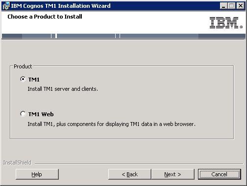

I have just installed 9.4 MR1 on our 64 bit test server. When I got to the screen shown here
if I chose "TM1" then clicking "Next" did nothing. I could not move forward.
I chose "TM1 Web" instead, then did a custom install so I could install what I wanted (which was most definitely not TM1 Web) so I got around it, but wondered if anyone else has run into the same issue?

Same issue at one of our clients when they installed 9.4MR1 on a new server. They are also using 64-bit and used the same workaround as you.
