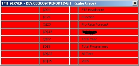

Re: *KEY_ERR Tracer
i cant get this to work, it shows all red rows and nothing in cols 1 & 3 for all rows even though the formula works and recalculates ok.
any ideas?
any ideas?

Re: *KEY_ERR Tracer
dubs
Perhaps you can add a few small screenshots to your post (or a new post)? (without sensitive information of course).
Wim
Wim
Re: *KEY_ERR Tracer
Cheers Wim,
yes may help?
it is is strange because if i do an alt+f9 then it all calculates correctly so the calculations work
yes may help?

dubs, which addin did you try? i just grabbed the latest from Steve and it's fine. The tracer is missing all the TM1 bits of info, so are you logged in (stock question i ask everyone!) and do you have the admin license rights? Excel can sometimes loose the link to TM1 even if the server explorer looks fine so might be worth closing excel and trying again as a startdubs wrote:Cheers Wim,
yes may help?
