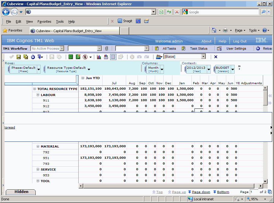

I had a similar issue, however I needed to change the css since I had TM1 Workflow configured in TM1Web.

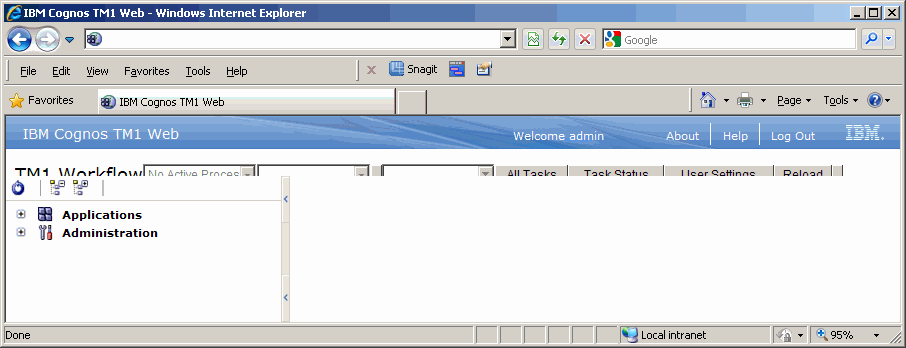

The Workflow toolbar would appear as unformatted when I used the default "TM1CustomStyles.css", see attached "tm1web.gif".

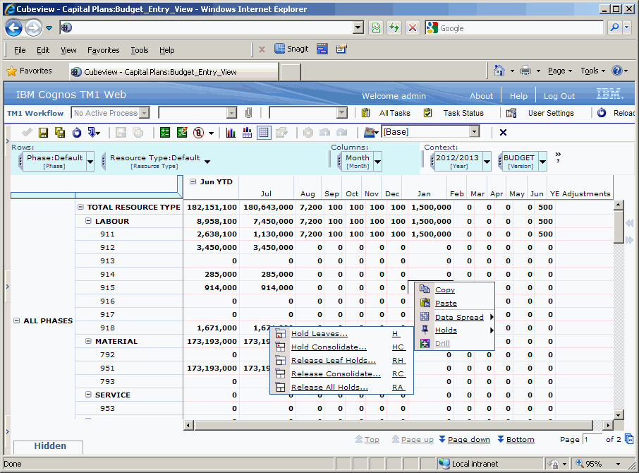

And if I applied "modern.css", it would apply correct formatting to the Workflow toolbar, but the right mouse click menu would be stretched to be unreadable (i.e. can't copy, past, apply data spread etc.), see attached "tm1web_modern.gif".
The only solution I found is to use the "corporate.css", which seem to resolve the above issues, , see attached "tm1web_corporate.gif".
Note: business.css and presentation.css would also work, HTH for future reference.
