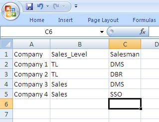

I have a problem that maybe you guys can help me out. I want security to be set out once an element is added. So I created a cube with {Groups and a measure as a picklist. The picklist will be the groups available in TM1. The text file as soon in the attachment contains the groups where elements are "WRITE" and the rest is looped as blank or no rights to the element.
I was thinking of firstly doing a conditional statement where the }Groups have attributes and those elements with attributes of "SALES" shall proceed to the next conditional while if not the item is skipped. But I still wasn't able to make out the comparison between the string in the source (attachment) against the DIMNM derived from the looping.
Technically...what's happening is if the Value is not equal to the GroupName it puts an empty on it. However base on the text file they match the group but somehow the code is not recognize the text file and }Groups element as the same.
Wanna know why its not working right.
textfile security.JPG (17.12 KiB) Viewed 12492 times

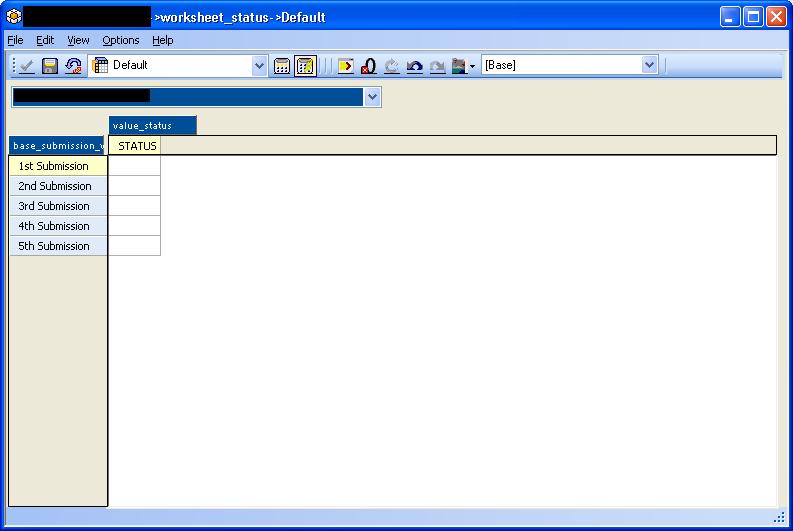

So I have a cube which has a status measure for that version has a text, it should move to the next element, however, I think its not moving to the next element. I need to check this so my version data in a version cube wont be lose. This is so I can keep versions of my data from my main data entry cube.
An explanation or alternative way to do this would be very much appreciated.

Thanks...however, I'm just having a lil confusion. I was expecting the loop to go through each element...but it ended up just putting data on the last. ( I tried this out with making my condition beIF (CellGetS(vStatusCubeName,so,VersionNo,'STATUS')<>@'REJECT');
) When I expected it should put data on all elements that meet the requirements.
Sorry for asking too much help from you guys...never really done looping through an element and loading data. (Still haven't gotten used to the looping for TM1 or programming) :(

I just need the TI to check the status in this cube. If the first submission has a reject then it should use the empty status and load data there and I want the process to stop there. And when the 2nd submission has a reject status...when the process is ran again it should skip the first & second submission. Cause the data shouldnt be overwritten or anything.
