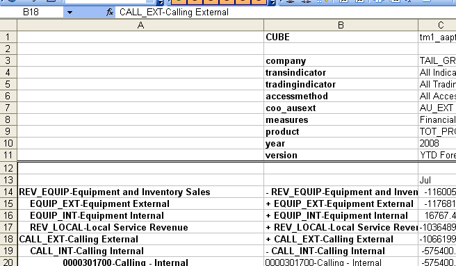

I am creating a report in Excel and used a Dynamic slice so that the user can drill down. The formating of the row dimension is not ideal and had for the user to follow as they drill down since we have a fragment Heirarchy. So what I did was add another column and used excel formula to insert space infront of the element in the row dimention so the dimention steps everytime we drill (see attached image "Report"). Column A has the Excel formula and column B has the element from the TM1 Dimentions called "Account"
The problem i am now having is that I want to be able to double click on the Excel formated line (Column A) to drill down but TM1 does not allow it.
what I then tried is using VBA. See code

I understand your frustration but i'm afraid what you are doing is not going to be possible. As soon as you edit a TM1 formula in Excel, you will break its functionality. Even adding a cell reference to a SUBNM will break the double click ability. Horrible as it is, your users will have to either live with it or use the cube browser directly.
