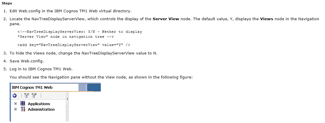

http://www-01.ibm.com/support/knowledge ... ane_N510F6
Hi Alan,
So is this still only a global option or do you know if it can be set per user?
Yeon

yyi wrote:http://www-01.ibm.com/support/knowledge ... ane_N510F6
Hi Alan,
This was so long ago that I don't even remember writing it. 9.1 and 9.5 were different animals and obviously 10.2 and the move from IIS to Tomcat quite different again. However the manual for 10.2.2 Web (page 84 of the .PDF) suggests that this is one thing that hasn't changed, aside from the name of the file that you modify:
Displaying or Hiding the Views Node in the Navigation Pane
You can display or hide the Views node in the Navigation pane.
Procedure
1. Edit tm1web_config.xml in the IBM Cognos TM1 Web virtual directory.
2. Locate the NavTreeDisplayServerView, which controls the display of the Server View node. The default value, Y, displays the Views node in the Navigation pane.
<!--NavTreeDisplayServerView: Y/N - Wether to display
"Server View" node in navigation tree -->
<add key="NavTreeDisplayServerView" value="Y" />
3. To hide the Views node, change the NavTreeDisplayServerView value to N.
4. Save tm1web_config.xml.
5. Log in to IBM Cognos TM1 Web.
Now the Navigation pane displays without the View node.
If IBM were to change it to a by-user selection, I would expect a new element to appear in the }ClientSettings dimension. I can understand why it would be nice if they were to do so but I wouldn't hold my breath for it.
