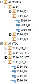

We were experiencing an issue which is kind of related to this:
We have a 'month' dimension as follows:
The issue was that when we set the default member to 2014_04, the MUN that was returned related to the All YTDs hierarchy rather than the All Months hierarchy.
I tried ensuring the indices of the All Months hierarchy came before the All YTDs hierarchy using dimensionsortorder, but this didn't resolve.
It turns out that BI will reference the MUN of the highest level occurence of the element - i.e. choosing 2014_04_YTD over 2014_Q2 because it's higher up in the hierarchy level.
In order to resolve this we simply added another consolidation above All YTDs.
Thought it was worth posting here in case anyone else experiences the same issue.
