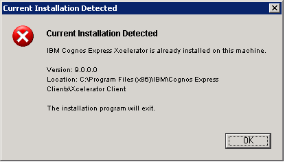

For reasons I won't go into, I ended up uninstalling and re-installing Cognos Express. I have successfully installed the Manager, and then from the Manger installed Xcelerator and Advisor.
I've then gone to the Welcome page and downloaded the Xcelerator and Advisor client packages (the client and server machines are currently one and the same). The Advisor client install has gone ok, but when I try to install the Xcelerator client I get the attached message telling me there is a current installation detected. It gives a folder location, but there is sweet FA in that directory.
I know it's possible for it to be installed, because I've done it before. But I've done a complete uninstall, deleted everything TM1ish I can find, yet this message.
I installed from the E:\ onto the C:\ is that a problem? This post mentions mapped/UNC paths, but not different local drives.
Any ideas?
While I'm at it, I thought Architect got installed along with any client (as discussed here), but it didn't show up last time till I installed Xcelerator. What if you haven't purchased Xcelerator? Do you have to install Xcelerator regardless, then delete tm1p.xla?

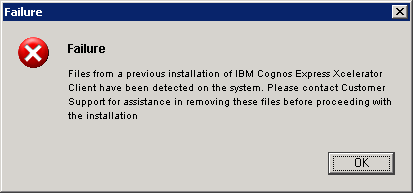

Martin UPDATE:
I installed fix pack one and it's been vaguely more useful. It now gives a slightly more useful error message (below) and looking at the error log it tells me that while there is no install directory, there is information in the Registry. It's not so useful as to tell me which registry keys I need to remove though. And there are heaps. In lots of random annoying places. The uninstall really doesn't clean up well after itself.
Moral of the story, don't uninstall the Xcelerator client.
Any ideas?

Martin,Martin Ryan wrote:For reasons I won't go into, I ended up uninstalling and re-installing Cognos Express...... Moral of the story, don't uninstall the Xcelerator client.
Not sure I agree with you, I think the moral is don't RE-install Cognos Express Xcelerator!
We had similar issues with a client and had to go through the whole painful process a couple of times. We did manage to get hold of a utility that clears the registry and that helps but it is still a pain.
At Iod in October I was sitting next to one of the senior IBM CX marketing people who was explaining the ease of install etc etc. i said it may be easy compared to Cognos BI but compared to TM1 it was awful; she seemed rather taken aback by that, particularly since the vast majority of CX sales seem to be based on TM1, sorry IBM Cognos Express Xcelerator .
