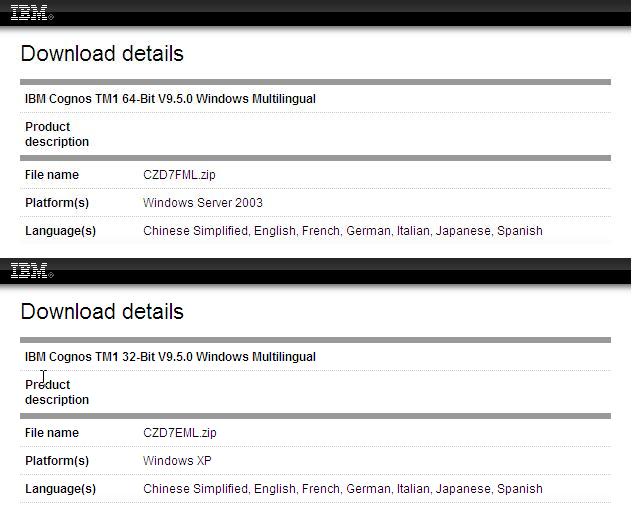

You will have to Unzip/Extract the *.tar.gz or *.zip files into seperate folders.shinymcshires wrote: He has copied all of the .tar.gz and .zip files to the target server.
I am assuming that you are doing a Windows Install of TM1 version 9.5.0. Depending upon the type of install (32-bit or 64-bit) you will one of the following files.
IBM Cognos TM1 64-Bit V9.5.0 Windows Multilingual(CZD7FML)
IBM Cognos TM1 32-Bit V9.5.0 Windows Multilingual(CZD7EML)
See the attached screen shot for details
- TM1 9.5.0 files to install
- TM1_950_installer.JPG (50.02 KiB) Viewed 7596 times
