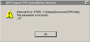

Just want to clarify something which I faced recently:
TM1 9.5.1 TM1 can not be installed on standard Windows 2008. It need Windows 2008 R2 (Realease 2) 64-bit. with latest Service Packs.
If you will try to install TM1 (with TM1Web) you will get an Error "Internal Error 27555". See the attached screen shot.
TM1 9.5.1 installation error on Windows 2008
Cheers!
Rizwan Kaif

IBM Support has advised me that TM1 9.5.1 TM1 can not be installed on standard Windows 2008. It need Windows 2008 R2 (Realease 2) 64-bit. with latest Service Packs.
According to IBM support if you are on Windows 2008 then the only option is to upgrade the OS to Win 2008 R2 or to get on Win 2003. I have not tried your suggestion...who knows may be it works :P
Cheers!
Rizwan Kaif

I also got internal error 27555 but with a different folder, C:\aspdir\TM1web\. I noticed my C: drive was amost full so I installed to another drive and it worked with no other changes.
Food for thought.
Mike

The Error "Internal Error 27555" with parameter 87 was only due to the incorrect Operating System. It was not related to the Disk space. Being a new server, I had Gigs of extra disk space.

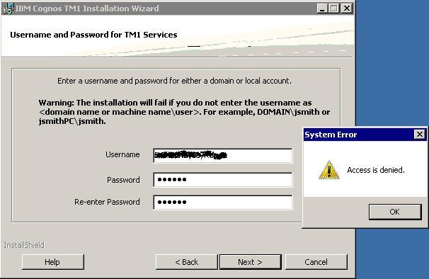

The client has now upgraded to Windows 2008 R2 and I was able to install TM1 9.5.1. This is a fresh install and is not an upgrade from a previous TM1 version.
During the installation of TM1 9.5.1 on Windows 2008 R2, it was not accepting my Domain user/password and I got error "Access is denied". I then figured out that you have to start TM1 SETUP as an Administrator. Right click on the SETUP.EXE and select "Run as Administrator".
Hope it helps!
TM1 9.5.1 install error on Windows 2008 R2
TM19.5.1_Install Error.jpg (37.08 KiB) Viewed 26174 times
Cheers!
Rizwan Kaif

rkaif wrote:During the installation of TM1 9.5.1 on Windows 2008 R2, it was not accepting my Domain user/password and I got error "Access is denied". I then figured out that you have to start TM1 SETUP as an Administrator. Right click on the SETUP.EXE and select "Run as Administrator".
That's a good and sometimes overlooked point. I've found that under Vista and later era OS's (Vista, 7, Server 2008) with most productivity software at least it's wise to run the install as Administrator to avoid curious and ill-documented side effects when you go to use it. I've also found this with Visual Studio, SQL Server and some others.

Few recommedations from my practice to avoid 27555 Internal Error:
1. Be sure that you user Windows 2003/2008 R2 release and only R2 release
2. Be sure that you already install IIS and ASP.Net components

TM1 Web works on Server2008, if you install the "IIS 6 Management Compatibility" in the Server Manager Web Server Role.
Greets Lal
