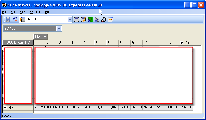

Cube 1 = 2009 HC Expense
  Dim1 = 2009 Budget HC
        Con. Elmt = 80400
             LfElmt = Employee1
             LfElmt = Employee2
  Dim2 = Cost Element
        Con. Elmt = Compensation and Benefits
             LfElmt = 601100
  Dim3 = Month
         Con. Elmt = Year
             LfElmt = 1

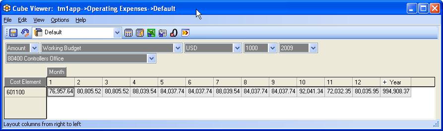

Rule works perfectly, but I have posted it below
#BUDGET HC EXPENSES
['601100','2009','Working Budget','1000','USD','Amount']=DB('2009 HC Expenses',!Cost Center,'601100',!Month);

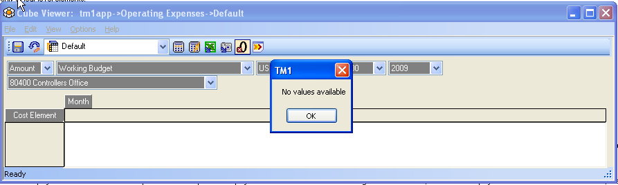

Feeder not working. Feeder is in Cube 2
['601100']=>DB('Operating Expenses',!Cost Element,!2009 Budget HC,'2009',!Month,'Working Budget','1000','USD','Amount');
After a bunch of trouble shooting I found out the following.
1) The issue appears to be !2009 Budget HC. If I hard coded it to '80400' the feeder works, but other wise it doesn't.
2) I thought the problem might the feeder flags needed to reset, so I rebooted the server....Still doesn't feed.
God help me if I am missing a comma or if something is misspelled!

Is your feeder really in Cube 2 Operating Expenses? Looks like it should be in Cube 1 2009 HC Expense.
Assuming that is a typo, what you want to happen is for HCExp['601100', '80400'] to feed OpEx ['601100', '80400'], where the HCExp 80400 is a consolidation, OpEx 80400 is a leaf.
I think your problem is that feeders only work at the leaf level, so the left hand side of your feeder will never attempt to process 80400, it will only look at {'Employee1', 'Employee2'} feeding OpEx, and as your Cost Center dimension doesn't have elements called Employee1 and Employee2 it won't feed.
Assuming that the 80400 level is always one above Employee1 level, try something along the lines of:
['601100']=>DB('Operating Expenses',!Cost Element,ElPar('2009 Budget HC, !2009 Budget HC, 1),'2009',!Month,'Working Budget','1000','USD','Amount');
