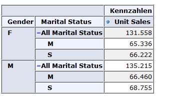

It returns data grouped by gender, then by marital status. How can I calculate me Unit Sales total but for Gender?

but it doesn't work, although I'm using [Gender].CurrentMember I still get the same numbers broken by marital status. Here's the result (through JPivot)
What I want to have is something like this (values circled in red are ones I want to calculate):

if you are referring to the mondrian example, don't ignore the already existing parent levels (e.g. "All Marital Status"):
your statement is:
select {[Measures].[Unit Sales]} ON COLUMNS,
{Crossjoin([Gender].[Gender].Members, [Marital Status].Members)} ON ROWS
from [Sales]
Try out what happens if you use [Gender].Members instead of [Gender].[Gender].Members also.
