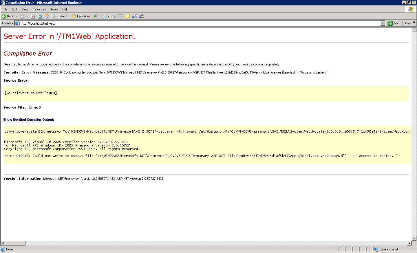

Hi to all,
I'm novice in TM1 and just install this on my notebook (win2k3 Server, MS SQL Server 2000 SP4, .NET Framework 2.0, 3.5) - after installing I've following error.
Please could you advise something?
BR,
Sander
BR,
Sander

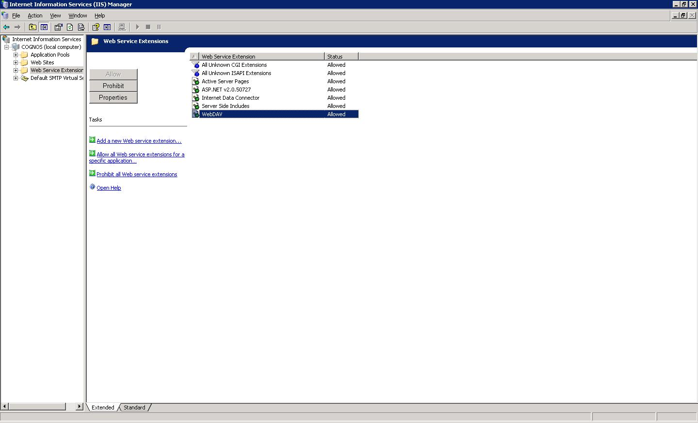

Thank to all for replies.
I'm sure that I've .Net framework 2.0.50727 ( look at screenshoot)
Also I install latest .Net framework 3.5 SP1

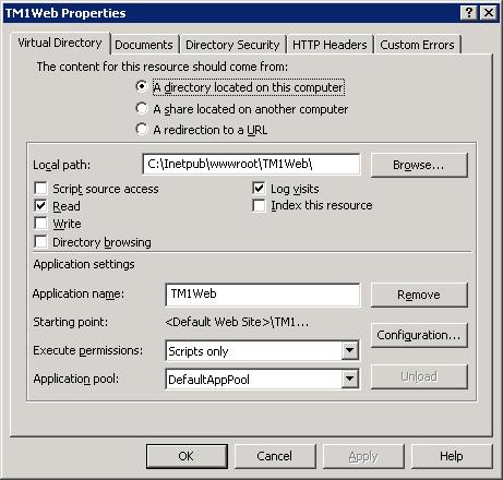

Go to IIS.
Expand Web Sites and Default web sites. Right click on TM1web and go to the properties. Choose the ASP.net bar and see what the ASP.Net version setting is.
HTH
Herman
Go to IIS.
HTH
Herman

Martin Erlmoser
- Posts: 125
- Version: 9.1.4 FP1
- Location: Vienna
Re: Error in IBM TM1 9.4 Web login
click on configuration (in your screenshot)
you can also see the used .net version on the used paths

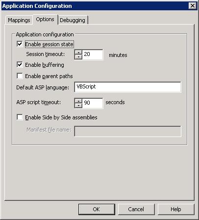

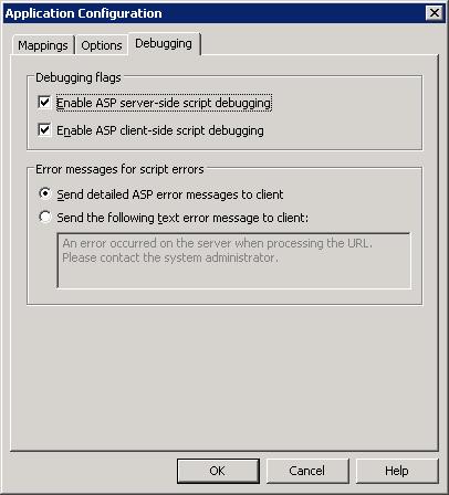

sander.mclean
- Posts: 8
- Joined: Thu Aug 28, 2008 8:25 am
sorry, may be I'm so stupid....
but where is it?
here all that i've on configuration
but where is it?
- IIS_Config2.JPG (29.86 KiB) Viewed 20294 times
- IIS_Config1.JPG (27.32 KiB) Viewed 20294 times
- IIS_Config.JPG (39.5 KiB) Viewed 20293 times

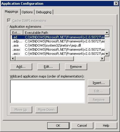

Martin Erlmoser
- Posts: 125
- Location: Vienna
mappings - executable path

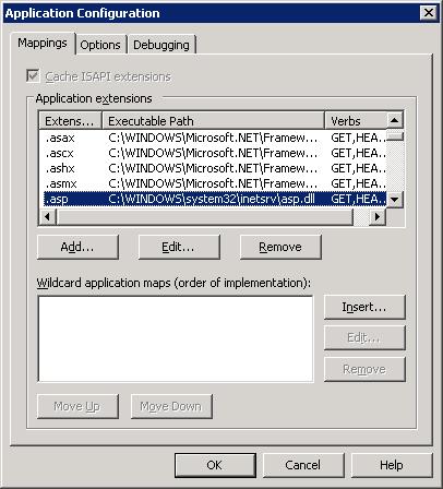

sander.mclean
- Posts: 8
sorry - for which one?Martin Erlmoser wrote:mappings - executable path
may be this information - you'd like?
- IIS_Mappings.JPG (40.02 KiB) Viewed 20280 times
