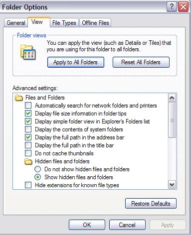

the TM1P.INI file should be under the folder
C:\Documents and Settings\<Username>\Application Data\Applix\TM1 and
C:\Documents and Settings\ALL USERS\Application Data\Applix\TM1
Check to change the folder options from.
In explorer "Tools\Folder Options\" , Select View tab, Under "Hidden files and folders" select: "Show hidden files and folders"
Folder options
Folder options
Folder Options.JPG (39.93 KiB) Viewed 7832 times
