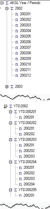

Re: Performing YTD and other relative time calculations in TM1
Please see the attached screen-shot of the sample Period dimension.
Hope this helps~!
Hope this helps~!
- Sample screen-shot of the Period dimension
- Period.JPG (25.19 KiB) Viewed 25898 times
Cheers!
rkaif wrote:Please see the attached screen-shot of the sample Period dimension.
Hope this helps~!
Rizwan, thanks for the screen shot. in this picture, is YTD2002 a sum of YTD200201, YTD200202, ...? If yes, then doesn't it have 200201 more than one time?
I think where I am struggling is more on the reporting side. Is there a way to have such a dimension where YTD is automatically calculated based on the current month that we are in (system date)?
Tutak,
In the sample as you can see YTD2002, YTD200201, YTD200202 etc are the consolidated elements. 200201 is a n-th level element and is appearing more than once in the screenshot due to the consolidations which we are creating in the Period dimension.
You have to load the monthly data once for each month and the Consolidations which we are creating here will do the job for you. For example if you are in month of March then you will have data in Jan, Feb and March. Other months (April & onwards) will have zero. So in March you will be able to see consolidated values for YTDJan, YTDFeb and YTDMarch & other YTDMonths will have zero
