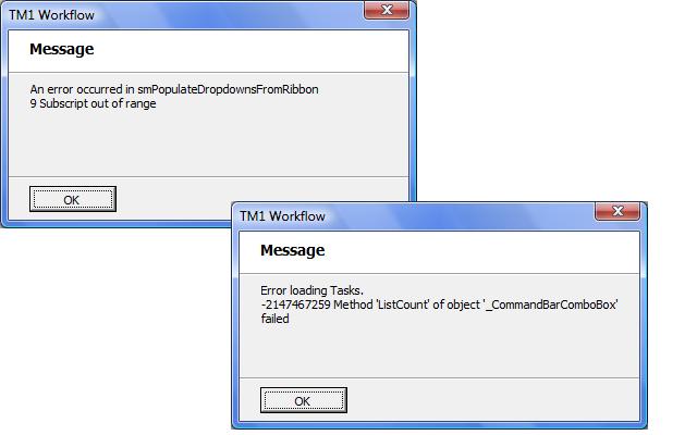

I tried the suggestion on that link. I change the compatibility flags for {0ECD9B64-23AA-11D0-B351-00A0C9055D8E} DWORD to 0 (it is the only key among four keys mentioned that have the compatibility flags)
Now I can click Admin button to open TM1 Workflow Administration Console and other buttons BUT the 'Load' button
When I click the Load button, i get this message:
- workflow error1.jpg (27.44 KiB) Viewed 7719 times

I uninstall KB973346 but still get the same error message when i click the Load button
