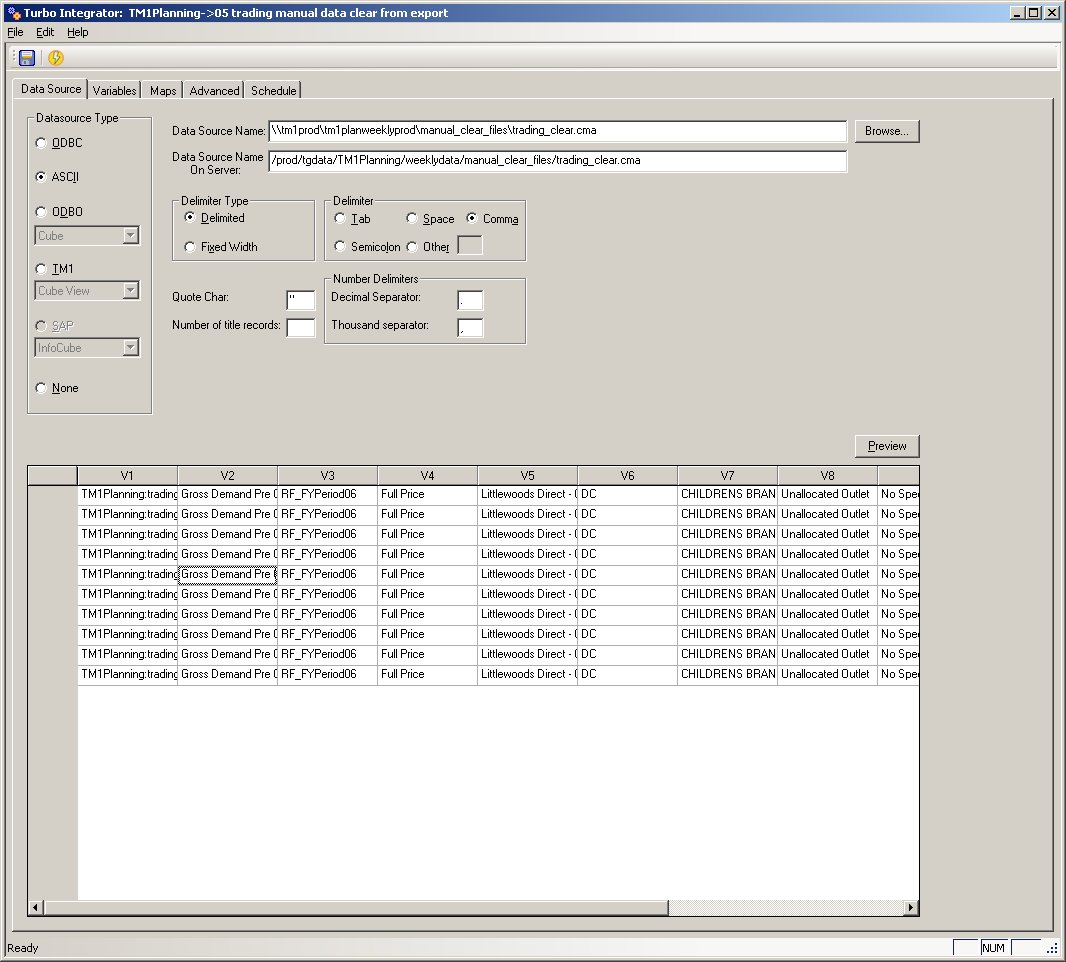

Just to folow up we use Unix and here is the front page of one of our processes. You can see the windows file path (shared with windows via Samba) in the first bar and the physical address on the UNix server in the second line. I hope this helps.

Thanks to both. This is what i was afraid of.
The way that you both mentioned is what I have been doing but we want to avoid coping files to our local PCs or even connecting our PCs to the UNIX servers.
Our files are rather large and this is a big issue for us going with UNIX. I wish it could just browse through the UNIX directory structure as well as be able to preview them.

I don't think you have much choice. This is what you get when mixing OS platforms. For those of us that user this kind of setup all the time samba becomes part and parcel of the solution,
Jim.
PS. I was pushed in to using Unix as our company policy is to use that platfrom for 64-bit computing. Would have prefered windows myself but there you go (For ease, oh and it's cheaper).
