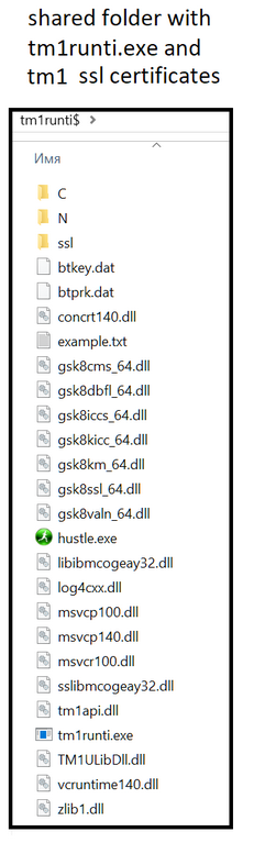

Re: Methods for Inputting Data into TM1 Cube
Excel + VBA:
1) First button on the sheet = write the range (or the desired cells and rows) to CSV (the directory and file must be accessible from tm1);
2) Second button on the sheet = run “tm1runti.exe” with parameters and call the process to read the CSV and write data to the cube.
- Example_2026.04.26_VBA.txt
- (5.74 KiB) Downloaded 1828 times
- Example_2026.04.26_tm1runti_files
- Example_2026.04.26_tm1runti_files.png (87.97 KiB) Viewed 28511 times
