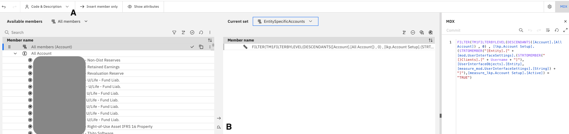

This MDX is currently saved as a dynamic subset. I've tried switching on the Alias PAW set editor but you cannot commit the change to the current set without overwriting the MDX set.
Below is the view of the set editor in PAW.
PAW Set editor
PAW Set editor
Screenshot 2023-06-26 at 12.49.04.png (103.02 KiB) Viewed 2923 times
I might have it wrong, but you cannot update a set by switching on the alias without updating/replacing the current set. This in turn changes it to a static set of accounts. You can switch on the alias on A but it only displays it in the 'Available members' section. The 'Current set' can only be updated by inserting or overwriting the current set with B.

Have you tried saving the subset in architect using the alias or alternatively via a ti process, using SubsetAliasSet?

The architect option did not work however, your suggestion of using SubsetAliasSet was greatly appreciated.
