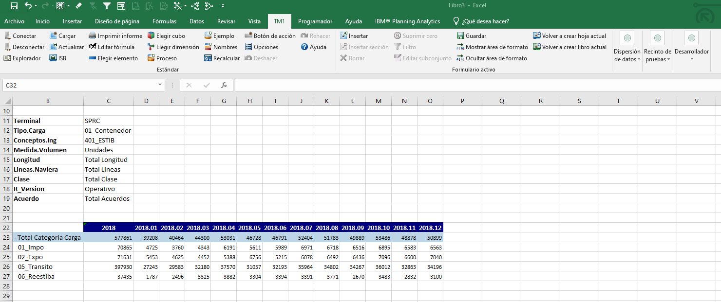

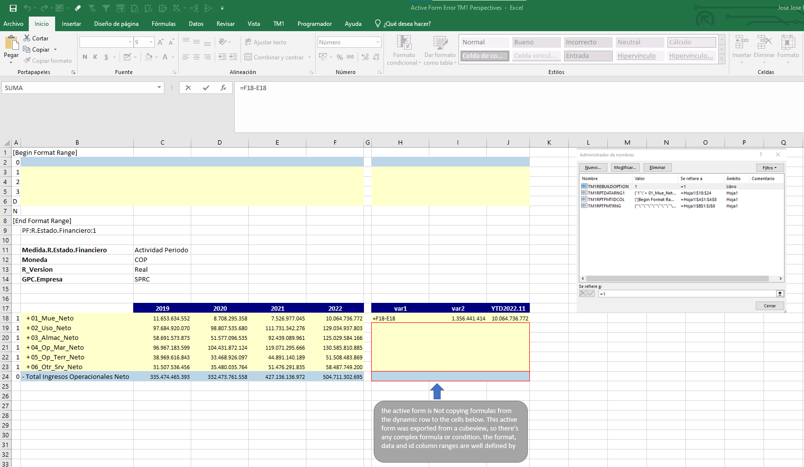

- Version EXCEL.png (3.91 KiB) Viewed 10315 times
- Active Form Error TM1 Perspectives.png (136.82 KiB) Viewed 10315 times

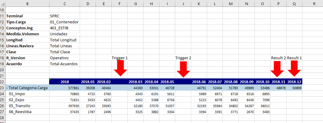

the last column of the data range gets wrong as it will not replicate formulas from the TRM1RPTROW to below cells.
And curious.. if you add a second column then the second column from rigth to left in data range gets wrong too and so on...
Please take a look on the following pictures in order and see how the error is triggered:
The steps to reproduce de error:Just on the off chance does it work without the column break in G?

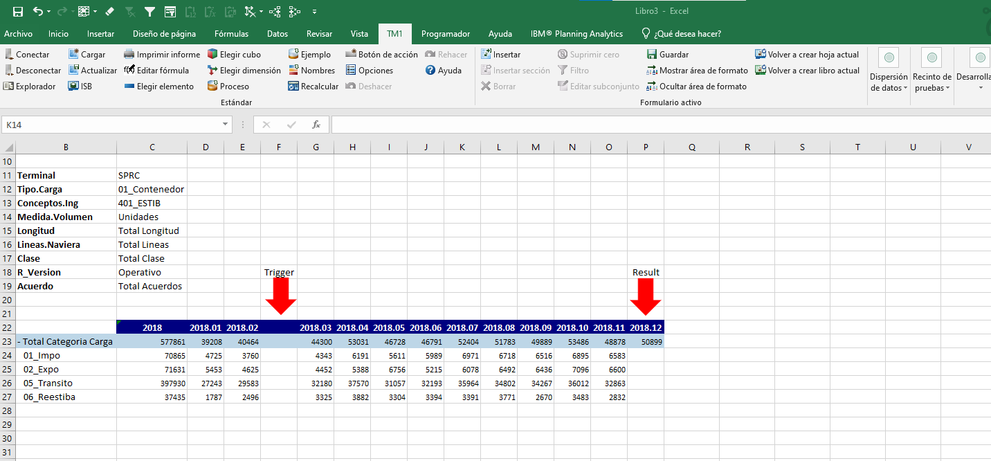

- step1 : export an active form from any cubeview using Tm1 perspectives
step2: insert a new blank column anywhere in the data range
step3 click on recreate the sheet or workbook

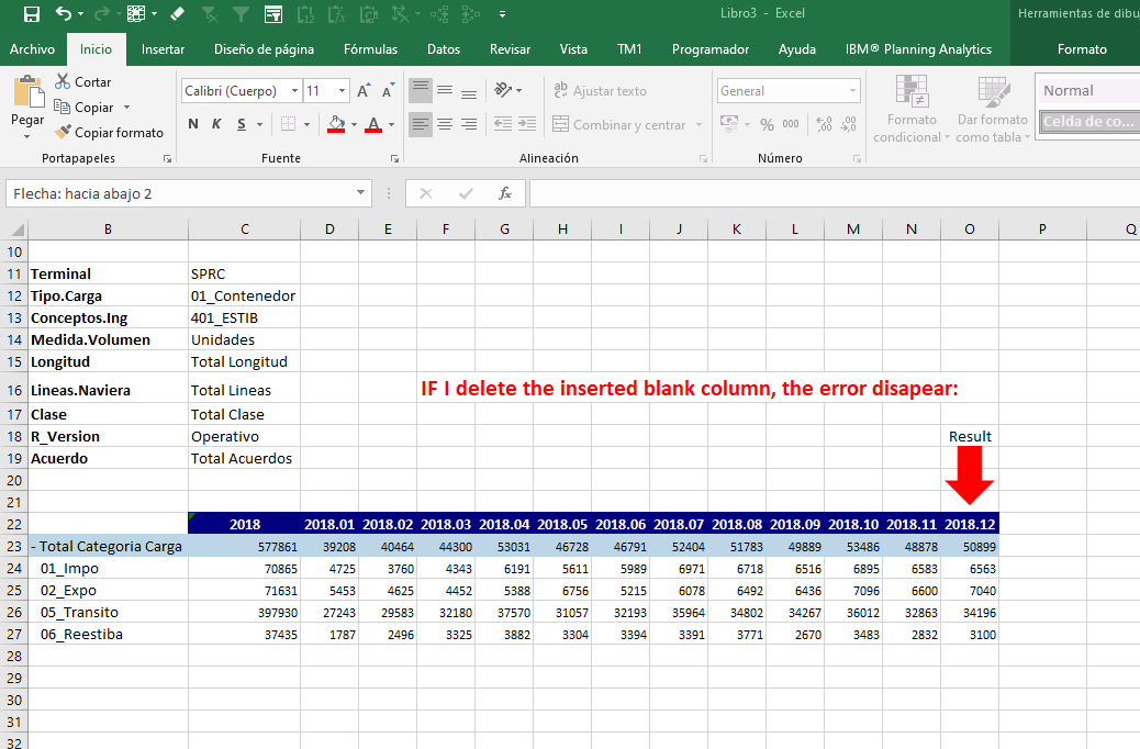

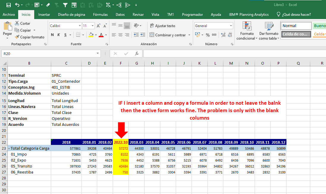

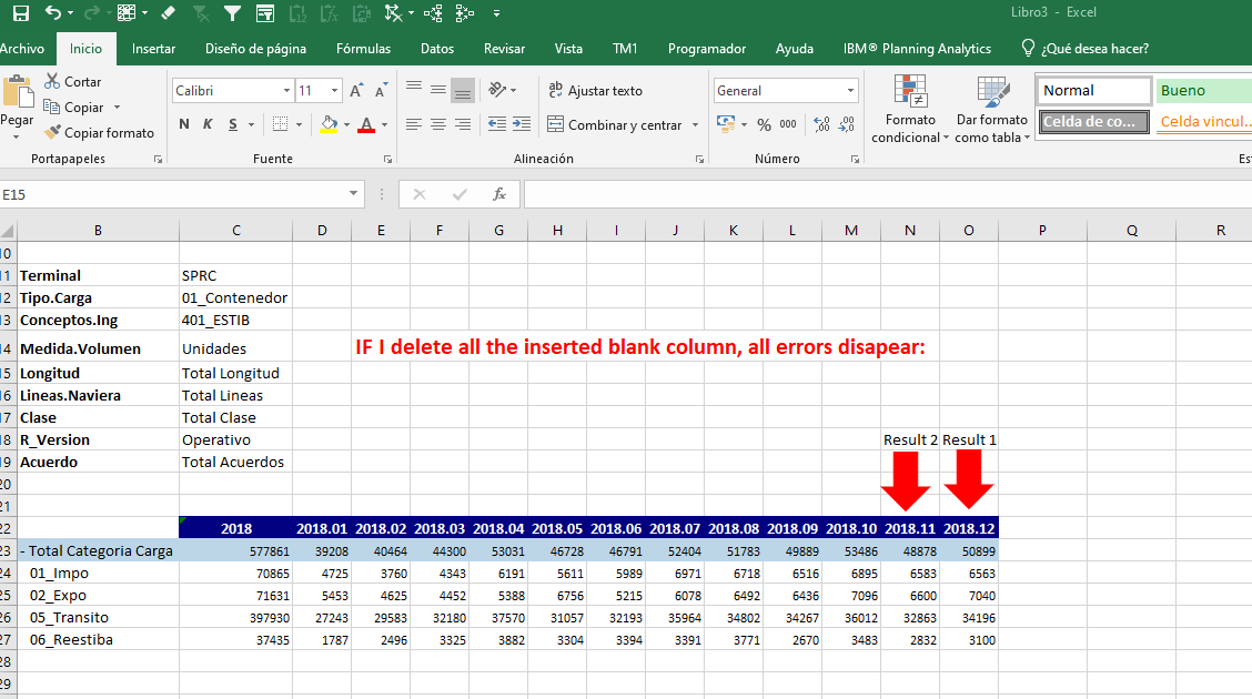

Now, please see what happen if I don't leave the blank and add any formula
and what happen IF I deleted the inserted blank columns:

If you put an apostrophe in the blank column you can probably keep your report layout working.
Re: TM1 Perspectives Active Form and O365 removing formulas
It is probably something along these lines.
The active form will count the number of non-empty cells in the first row, the TM1RPTROW row, and create the range to encompass these.
If you have empty cells, they are not counted towards the total, and hence too few columns have their first row copied downwards.

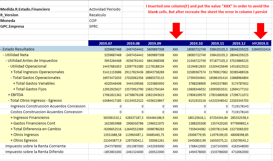

Hi Wim and Steve,
Thanks for your comments.
I was testing what you proposed, but I got the same results:
- test.png (59.43 KiB) Viewed 10242 times
What happens if you fill the blue cell right underneath the left red arrow ?

I populated the blue title with the same string, a diferent period but nothing changes...
Only when I add a DBRW formula that uses the TM1RPTView the problem disapear.
