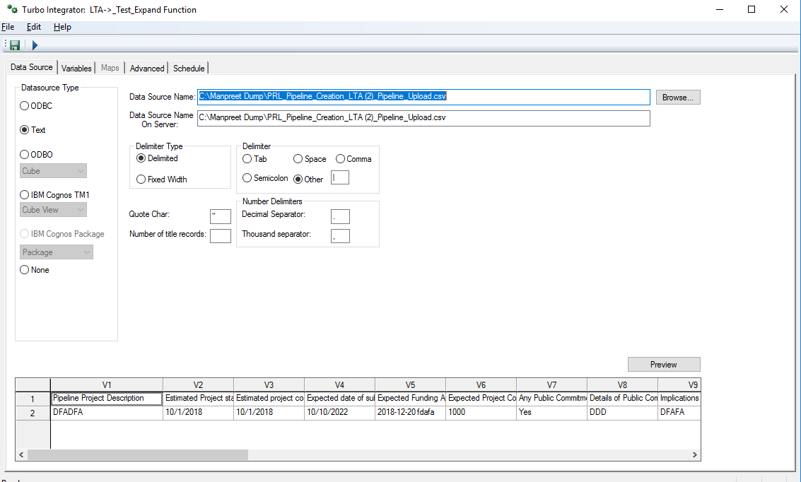

Data source Tab screenshot in TI.

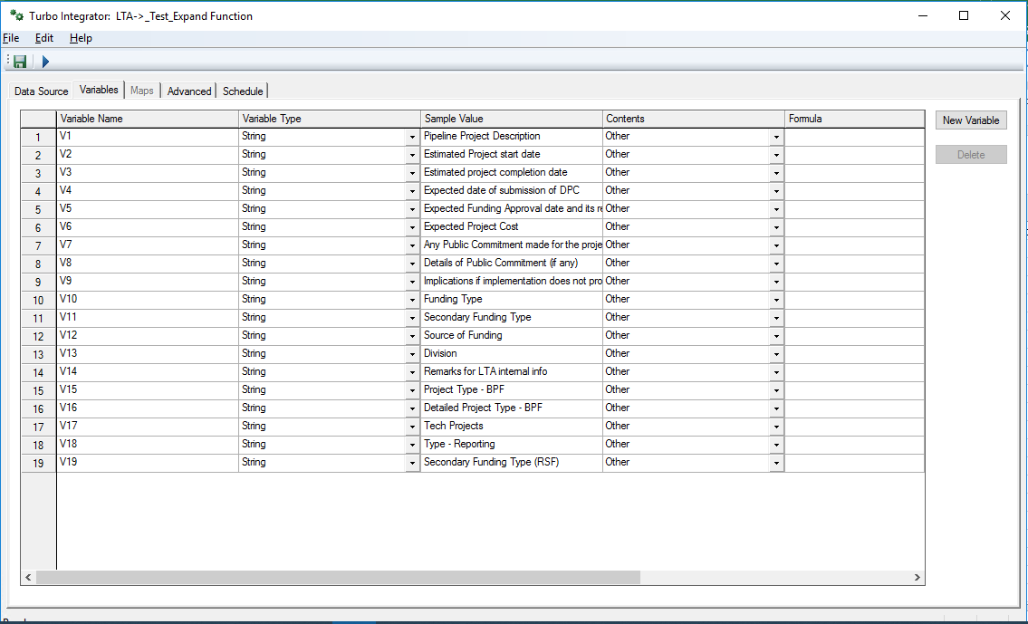

Variable Tab Screenshot in TI.

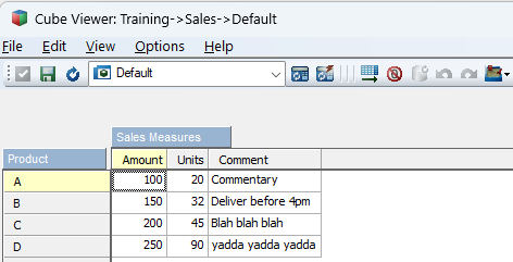

I then set the attributes on my Sales Measures to align to V1, V2, V3 etc. per my Sales Data: Back in my TI I can write the code needed to process each field in the source file and write it to the mapped Sales Measures:
After running my code I have the following:
Hope that illustrates better what I was trying to explain.
