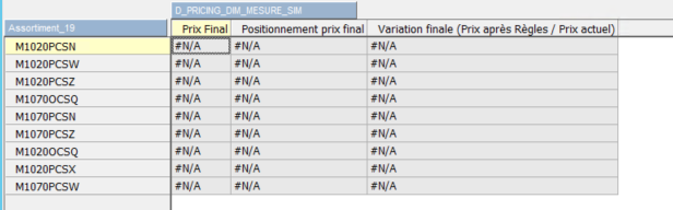

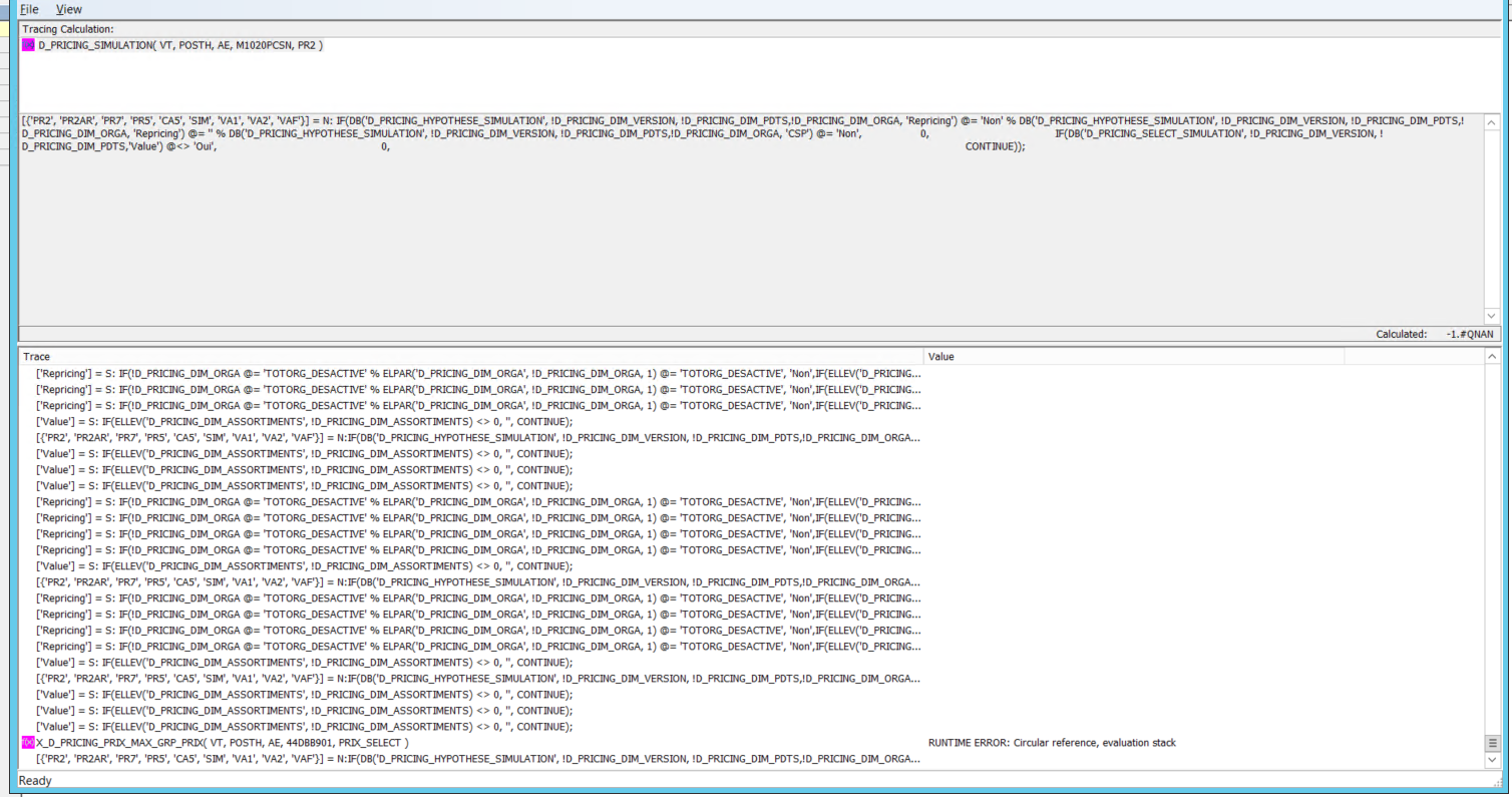

hi,
today, i got this error that i never seen that before, so, any help or any exp will be appreciated ! :idea:
thanks !
my trouble
trouble rule.png (45.29 KiB) Viewed 3738 times
trouble rule 2.png (568.71 KiB) Viewed 3738 times

Thank maren for the reponse, problem solved, i found that i compare A with B while B is calculed by A. but i still dont understand why it cause reference circular error.
B = A * coefficient (0,1-1)
i have a condition if (B>A), B, A.
I still need to do this and i need to understand why there are a reference circular here. :ugeek:

Re: rule line error runtime error :circular reference, evaluation stack
wrt to a circular reference one thing that isn't always obvious until it happens to you the first time is that you need to consider rules and consolidations in the dimension together.
To illustrate this with a silly example.
Say your period dimension has Jan rolling into Year.
and you write a rule
['Measure A' , 'Jan']=N: ['Measure A', 'Full Year'];
Then you create a circular reference since in the rule Jan depends on Full Year and in the consolidation Full Year depends on Jan.
Note though that the below isn't circular (unless Measure B and Measure A are also dependant on each other).
['Measure A' , 'Jan']=N: ['Measure B', 'Full Year'];

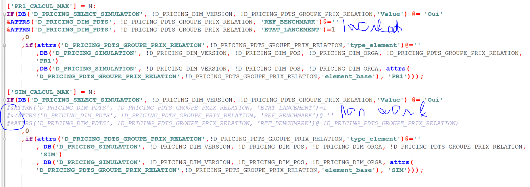

probleme is on this line, but this line dont make the trouble in the first case (PR1 MAX)
rule line error.png (374.7 KiB) Viewed 3577 times
['PR1_CALCUL_MAX'] = N:
IF(DB('D_PRICING_SELECT_SIMULATION', !D_PRICING_DIM_VERSION, !D_PRICING_PDTS_GROUPE_PRIX_RELATION,'Value') @= 'Oui'
&ATTRS('D_PRICING_DIM_PDTS', !D_PRICING_PDTS_GROUPE_PRIX_RELATION, 'REF_BENCHMARK')@=''
	,0
	,if(attrs('D_PRICING_PDTS_GROUPE_PRIX_RELATION',!D_PRICING_PDTS_GROUPE_PRIX_RELATION,'type_element')@=''
		,if(DB('D_PRICING_SIMULATION', !D_PRICING_DIM_VERSION, !D_PRICING_DIM_POS, !D_PRICING_DIM_ORGA, !D_PRICING_PDTS_GROUPE_PRIX_RELATION, 'SIM')<DB('D_PRICING_SIMULATION', !D_PRICING_DIM_VERSION, !D_PRICING_DIM_POS, !D_PRICING_DIM_ORGA, !D_PRICING_PDTS_GROUPE_PRIX_RELATION, 'PR1')
			,DB('D_PRICING_SIMULATION', !D_PRICING_DIM_VERSION, !D_PRICING_DIM_POS, !D_PRICING_DIM_ORGA, !D_PRICING_PDTS_GROUPE_PRIX_RELATION, 'PR1')
			,DB('D_PRICING_SIMULATION', !D_PRICING_DIM_VERSION, !D_PRICING_DIM_POS, !D_PRICING_DIM_ORGA, !D_PRICING_PDTS_GROUPE_PRIX_RELATION, 'SIM'))
		,DB('D_PRICING_SIMULATION', !D_PRICING_DIM_VERSION, !D_PRICING_DIM_POS, !D_PRICING_DIM_ORGA, attrs('D_PRICING_PDTS_GROUPE_PRIX_RELATION',!D_PRICING_PDTS_GROUPE_PRIX_RELATION,'element_base'), 'PR1')));
Anyway, thanks for your help ! now, i know where is the problem, i will just delete it and try to make another way. i'am not very smart on math :mrgreen:
Post by MarenC »
Bit puzzled why the REF_BENCHMARK ATTRS for D_PRICING_GROUPE_PRIX_RELATION would be asking if it was equal to itself?
If you removed that ATTRS does it work then?
Other than that not enough information to provide an answer and as others have already said, not something anyone has time for really.
Maren
mrdauduong
Posts: 52
Joined: Mon Sep 26, 2022 11:10 am
Version: PA 2.0.74.23
Excel Version: Excel 2016
Post by mrdauduong »
Thank maren for the reponse, we can close the topic here.
To answer your question :
- Bit puzzled why the REF_BENCHMARK ATTRS for D_PRICING_GROUPE_PRIX_RELATION would be asking if it was equal to itself? ==> because i have to apply this rule only for the element who have himself in the attribut REF_BENCHMARK
- If you removed that ATTRS does it work then? => it work if i romove that ATTRS, this is why i dont understand :mrgreen:
