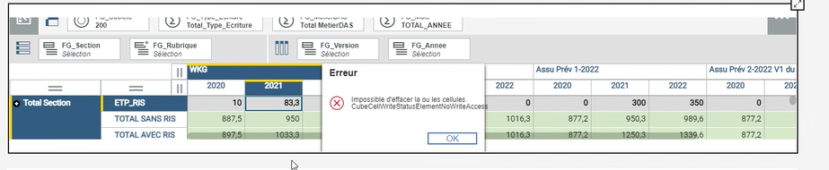

my client have this trouble when i try to enter a value in this cell (this is a consolidated cell)
tm1 right question.png (115.76 KiB) Viewed 2300 times
right now, the only thing that i can do is give him a admin right, if not, he can not write in this cell.
i need to solve this probleme as soon as possible. and i have no idea why. any help will be appreciated !

Looks like you are trying to do a spread, i.e. data entry at the C level. Judging from the error message the user doesn't have write access at the C level intersections in the view.
So I'd say recheck the security model but make sure you consider that they need WRITE access at the C level to do so.

thanks for the help Steve, i check again in }ElementSecurity_DIMENSION and i found the probleme, i dont have write acces at the C level. i add this and it worked!
