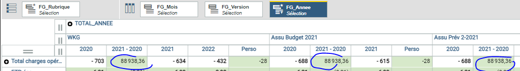

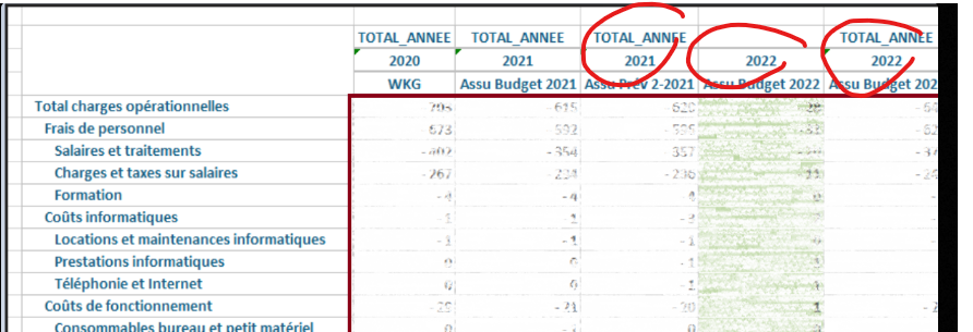

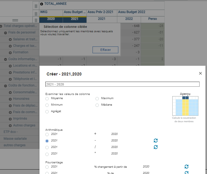

Question 1 : they have 2 dimensions YEAR and VERSION and they want to make a calcul for exemple : VERSION A YEAR 2022 - VERSION B YEAR 2021
==> is there any way to do it on exploration view? (when i try to insert calcul, i can only chose 1 dimension)
Question 2 : then i try another way, i tried to "insert user row/colum" (function only available on PAX) and put a perso excel formula on it, it work well, but my colum inserted is always on the left of element, and i can not move to the right or the end of table. and when i try to rename the colum, it show i can not rename the colum.
If someone could advise to me how bypass this, I would appreciate.

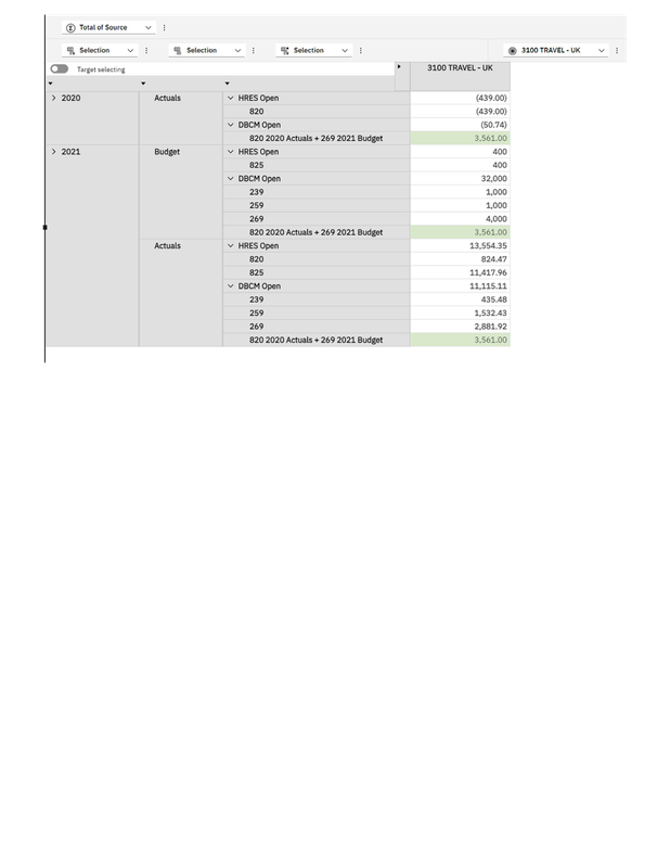

Another way to do it and it worked from 2.0.62 version
Just a small addition to Andrew's answer.
Asymetric calculations are now supported in Exploration in Workspace, so the calculation between the two columns in you view can be done by the calculation options menu :
Reference in the documentation for classic views : https://www.ibm.com/docs/en/planning-an ... assic-view

hi Maren,
yes, iam able to do this calcul VERSION A YEAR 2022 - VERSION B YEAR 2021
i follow the produre of this link https://www.ibm.com/docs/en/planning-an ... assic-view
- Click the Targeted selection icon for the axis where you want to create the asymmetric calculation. Targeted selection icon for rows for rows and Targeted selection ison for columns for columns.
- Select the members you want to be included in the calculation. Use CTRL+click to select multiple non-adjacent members, use SHIFT+click to select multiple adjacent members. The asymmetric calculation will be inserted adjacent to the last member you select.
- Right-click a selected member, then click Create calculation.
- Select the calculation you want to apply.

options that comes up is VERSION A YEAR 2022 - VERSION B YEAR 2021? ==> the option is always 2022-2021 but the result is different. only VERSION A YEAR 2022 - VERSION B YEAR 2021 for all version
MarenC wrote: ↑Mon Oct 10, 2022 2:25 pm Hi,
So when you Ctrl click to select the target members you are doing the following:
Ctrl click VERSION A, Ctrl Click Year 2022, Ctrl Click VERSION B, Ctrl Click Year 2021?
You then right click and create calculation and one of the options that comes up is VERSION A YEAR 2022 - VERSION B YEAR 2021?
I would be really interested to see the screenshots for that!
Maren
- photo 1.png (52.74 KiB) Viewed 39093 times
- photo 2.PNG (21.83 KiB) Viewed 39094 times

Keith Would
- Posts: 13
- Joined: Tue Dec 06, 2016 11:24 am
- Version: 10.3.0
Re: TM1 PAW - Exploration view - Insert calcul on 2 dimensions
It does work, that probably wasn't clear from the screenshot or the explanation.
When the arithmetic options come up, they only show one element (in my example 825 and 269) not all of the selection. Hence why in the above it just shows 2021 - 2020.
