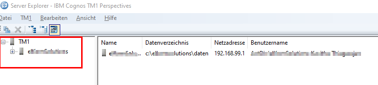

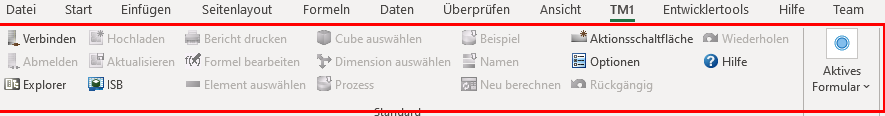

I have tried to connect to TM1 Perspectives in IntegratedSecurityMode 5 with CAMPassport in excel vba automatically.
Previously with 'N_CONNECT_CAM' with n_connect_cam_bridge.dll worked well in excel 32 bit. In the current latest vesion of TM1 Pespective will support only 64 bit. Same dll is not supported in 64 bit. So I set the CAMPassport in vba and connect to TM1 Perspectives as a workaround.
The problem is its connected to TM1 Perspectives but ribbon is not activated.
Kindly provide your input on this.
