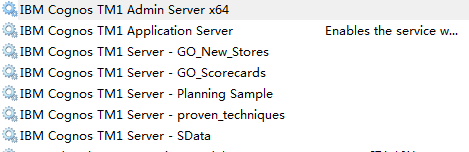

Hi Buddy
All the related Service is openned
Service list
Service list

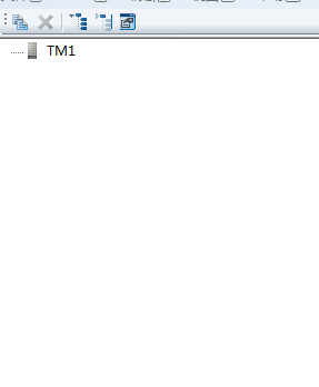

But the sample instance cannot be seen on the architect panel while it reports this kind "5498" error
The firewall has shut down.
