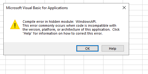

by the way I could able to findout issue. it is SSL issue that I need to update SSL then it worked. but I am getting different issue now:
My AWS is windows 10 and Excel version 2008/Office 365 and I installed the perspectives 64-bit (TM1 10.2.2). while opening my TM1 reports (VBA code/macros) for testing/input numbers then it is showing that incompatible (attached error). My question is, 32-bit perspectives would it support? Is there anyone come across similar issue?
- VBA error.PNG (7.89 KiB) Viewed 5975 times

I am fairly certain Excel 2008 didn’t have a 64-bit option.mincharug.shulft wrote: ↑Fri Sep 24, 2021 6:31 pm My AWS is windows 10 and Excel version 2008/Office 365 and I installed the perspectives 64-bit (TM1 10.2.2). while opening my TM1 reports (VBA code/macros) for testing/input numbers then it is showing that incompatible (attached error). My question is, 32-bit perspectives would it support? Is there anyone come across similar issue?
You can only use 64-bit perspectives with 64-bit Excel.
So yes you will need to uninstall the 64-bit and then install the 32-bit version, or get a newer 64-bit Excel.
