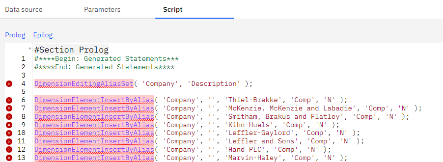

Then this code can be run (or you use a data source rather then all Prolog tab code):
DimensionEditingAliasSet( 'Company', 'Description' );
DimensionElementInsertByAlias( 'Company', '', 'Thiel-Brekke', 'Comp', 'N' );
DimensionElementInsertByAlias( 'Company', '', 'McKenzie, McKenzie and Labadie', 'Comp', 'N' );
DimensionElementInsertByAlias( 'Company', '', 'Smitham, Brakus and Flatley', 'Comp', 'N' );
DimensionElementInsertByAlias( 'Company', '', 'Kihn-Huels', 'Comp', 'N' );
DimensionElementInsertByAlias( 'Company', '', 'Leffler-Gaylord', 'Comp', 'N' );
DimensionElementInsertByAlias( 'Company', '', 'Leffler and Sons', 'Comp', 'N' );
DimensionElementInsertByAlias( 'Company', '', 'Hand PLC', 'Comp', 'N' );
DimensionElementInsertByAlias( 'Company', '', 'Marvin-Haley', 'Comp', 'N' );
DimensionElementInsertByAlias( 'Company', '', 'Smitham, Rau and Greenfelder', 'Comp', 'N' );
DimensionElementInsertByAlias( 'Company', '', 'Becker, Bode and Sporer', 'Comp', 'N' );
DimensionElementInsertByAlias( 'Company', '', 'Kuhic Inc', 'Comp', 'N' );
DimensionElementInsertByAlias( 'Company', '', 'Rempel-Nader', 'Comp', 'N' );
DimensionElementInsertByAlias( 'Company', '', 'Quitzon, Moen and Nienow', 'Comp', 'N' );
DimensionElementInsertByAlias( 'Company', '', 'Ortiz-Carroll', 'Comp', 'N' );
DimensionElementInsertByAlias( 'Company', '', 'Doyle Inc', 'Comp', 'N' );
DimensionElementInsertByAlias( 'Company', '', 'Fisher-Kertzmann', 'Comp', 'N' );
DimensionElementInsertByAlias( 'Company', '', 'Spencer-Cruickshank', 'Comp', 'N' );
DimensionElementInsertByAlias( 'Company', '', 'Ullrich-Nienow', 'Comp', 'N' );
DimensionElementInsertByAlias( 'Company', '', 'Larkin-Lueilwitz', 'Comp', 'N' );
DimensionElementInsertByAlias( 'Company', '', 'Jacobi Inc', 'Comp', 'N' );

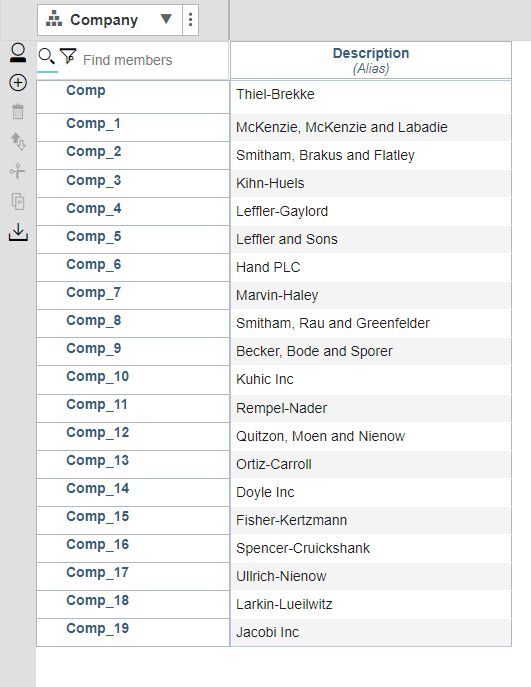

Result:
"Comp" is the common part that is prefixing an underscore character and an incrementing number.

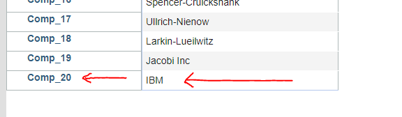

You don't need to store 19 as the last index. Adding a new company name with:
DimensionElementInsertByAlias( 'Company', '', 'IBM', 'Comp', 'N' );
gives you:

- Architect / Perspectives allow to save the process, PAW does not and you will be confronted with a sea of red squiggles. It's up to you whether you want that or not, besides the fact that these functions are undocumented but exist for a very long time in TM1.

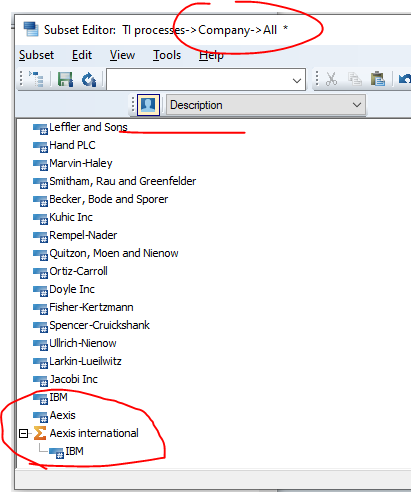

Re: DimensionElementInsertByAlias and DimensionEditingAliasSet
TM1 will create Comp_2 and Comp_20. So filling up the gaps first.
Adding elements works fine too:
DimensionElementInsertByAlias( 'Company', '', 'Aexis international', 'Comp', 'C' );
DimensionElementComponentAdd( 'Company', 'Aexis International', 'IBM', 1 );
