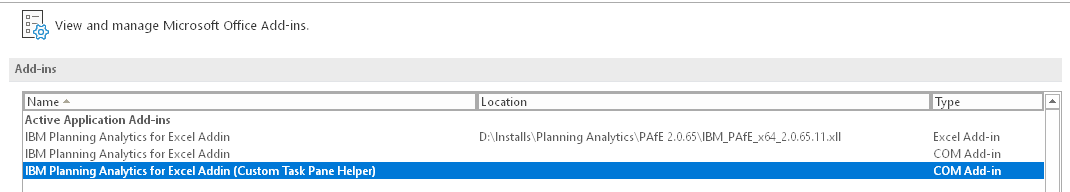

When you hit PAfE 2.0.65 then Addins change again:
