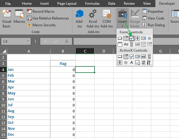

  1. First we need to enable Developer ribbon (right-click on ribbon, "customise the ribbon", enable "developer" ribbon)
  2. On the "Developer" ribbon, select Insert, Checkbox. Place it somewhere

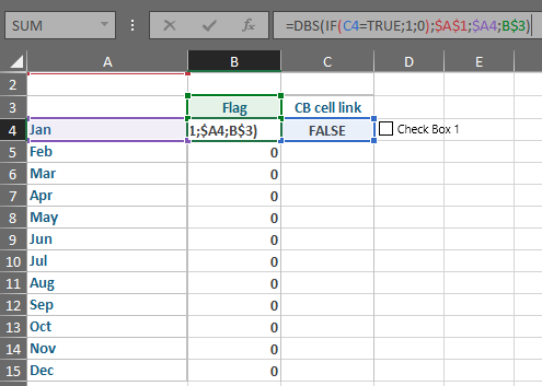

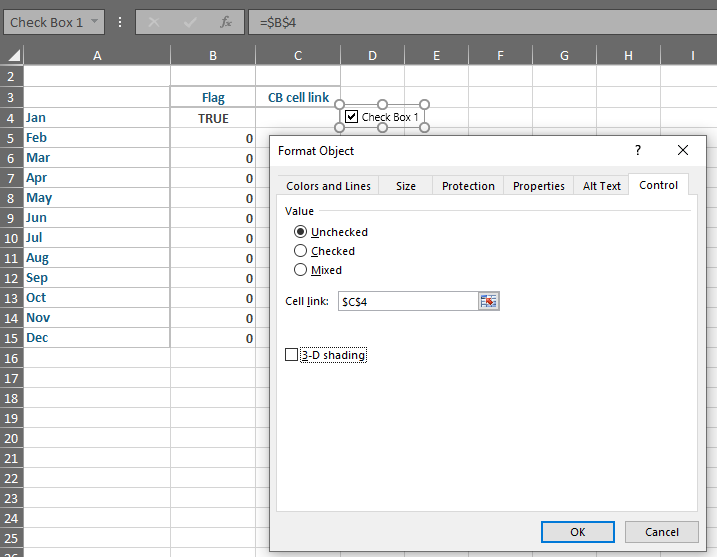

  3. Right-click on the created checkbox, Format control, assign the cell link to a cell near your target flag cell
    Format control.png (24.89 KiB) Viewed 52923 times
  4. Write a DBS formula in your target flag cell, pointing to the desired "flag" cell, to send 1 or 0 to the server depending on the checkbox status: "=DBS(IF(CheckBoxCellLink=TRUE;1;0);Server;coordinates)"
Viola, it works, including websheets.

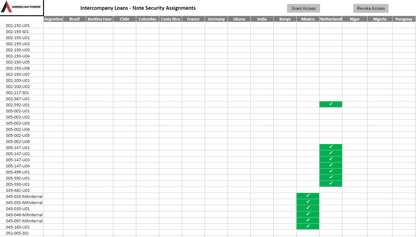

I use checkboxes in TM1 sometimes to indicate to a user whenever something is turned ON or OFF but I use a font to do it. In Wingdings 2, uppercase P is a check mark. I can then use an IF statement in the form to "turn" the value in the flag field to "P" if it is on or nothing if off. In the active form I will pull back all the flag values from the cube, hide those columns, and then have columns to the right with formulas like =IF((N8="WRITE"),"P",""). In this example I am pulling back values from an }ElementSecurity cube in column N and displaying a check mark if the group has WRITE and nothing if not. I also make the background green by conditional formatting if the value in the cell is "P". To turn the flag on or off I have an action button that runs a TI process that uses a pair of Excel OFFSET formulas to determine the row and column where the cursor is currently located to pass the selected element and group as parameters to the TI process to toggle the flags. The offset formulas are (where Start is a cell one row before the first value in the rows and one column to the left of the starting column)
Row - OFFSET(Start,(@CELL("Row")-ROW(Start)),0)
Column - =OFFSET(Start,0,CELL("Col")-COLUMN(Start))

The purpose of the OFFSET formulas is not to get the value in the cell, it is to get the value in the dimension element row (the values in the first column on the left) and the value in the security groups column (the values in the country row at the top). So, for example, if my cursor is in the cell corresponding to the intersection of 002-592-U01 and Netherlands then my Row indirect formula resolves to "002-592-U01" and my Column indirect formula resolves to "Netherlands". I pass both of these as parameters to the TI formula called by the action button so the TI process knows which Note# and Country to either take away or give access to. If the button clicked is "Grant Access" then the TI process is going to put a value of "WRITE" in the }ElementSecurity_ICNote cube for the note# and group. If the button clicked is "Revoke Access" then it is going to clear the value in the }ElementSecurity cube. If you want, you can just have a single action button called "Toggle" and you can have the TI process determine the current state of the Note#/Group intersection and then reverse it every time the button is clicked.
The point of all of this is so a user doesn't have to key in the Note# and Group they want to modify security for, they can just put the cursor in the appropriate intersection and click on the action button.
