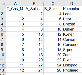

I am attempting to load data from CSV file into the cube Sales in the following way:

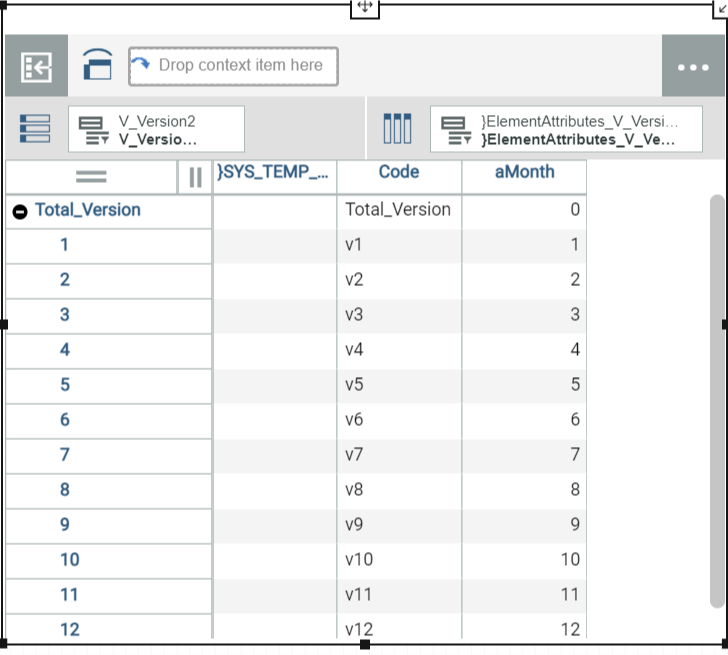

insert attributes into Version dimension (viz img):
Then in a process with CSV file as datasource I would specify the appropriate month with CellGetN command, which I would afterwards use in CellPutN/S commands. The problem is, taht no matter what parameter I use, I always insert data corresponding to the December. I have no idea why.

nElVersion = NumberToString(CellGetN(sSourceCube, pVersion, aMonth));

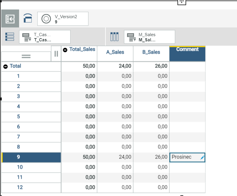

Wrong Result after spicifying the parameter pVersion to be 9:
I know I dont have defined Source and Target Views which is a mistake, but in this case i presume it should not be the cause of the problem. I would appreciate any help or pointers to what might be wrong.

vasek1192 wrote: Mon Feb 15, 2021 10:35 pmThe problem is, taht no matter what parameter I use, I always insert data corresponding to the December. I have no idea why.
vasek1192 wrote: Mon Feb 15, 2021 10:35 pmWrong Result after spicifying the parameter pVersion to be 9.
Hi Vasek,
I’m a little confused.
You mention the data always shows in December.
Then you specify 9 as the pVersion parameter, and the screenshot shows data in (row) T_Cas.. 9 when V_Version2 (context) is filtered to 9.
What exactly is the issue?
What do you expect to see in the cube view?
Does your CSV have more lines than your example screenshot shows?

Thanks for the reply. Yes the CSV file has 12 rows + title. The problem is not the location to which the process allocated the data. The problem is the data itself. He always puts data from December into the cells specifies by parameter. If I set pVersion as 9 he should take data from September and insert them into Version 9, September. Instead he Always takes data from December.

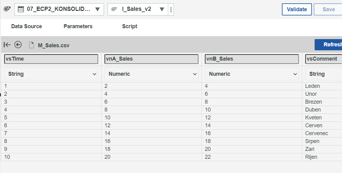

You are using a parameter in your cellputn - this is controlling which cells you write into.
However, you have made no filter on your datasource. So the CellPutN runs for every line of your source data, so it has loaded each row into the same target cells of "Version 9". The last row of data is "December" so that is the one that ends up in the system.
You need to filter the source data in some way e.g.
If ( vsTIme @= pVersion );
   # Do Stuff
Else;
   # Don't do stuff
EndIf;
