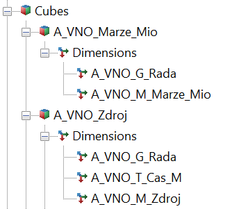

Hi, I am attempting to transfer data from cube A_VNO_Zdroj into cube A_VNO_Marze_Mio. A_VNO_Marze_Mio has one less dimension - A_VNO_T_Cas_M. Data I need to transfer is allocated to elemnt Marze in dimension A_VNO_M_Zdroj.

I note that the Source and Target cubes only have one dimension in common, as well as the Source having an extra dimension.
You are reading from a cube that has one more dimension than the target but you are not specifying the source element in the A_VNO_T_Cas_M dimension

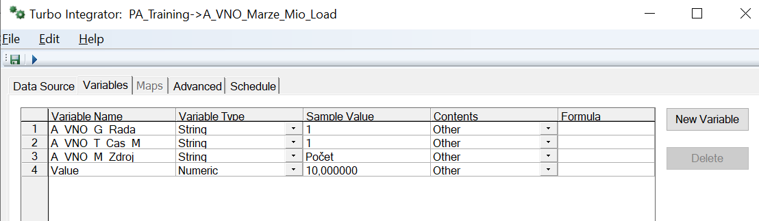

Looking at your Variable names you seem to have a space in them but I cannot tell if the underscore has been lost in the image. They should have an underscore like your image of server explorer.
Your Data Tab is OK. However, if you subsitute the hard-coded 'Marze' with the variable A_VNO_M_Zdroj then it will be more flexible in future if you want to adapt this process to transfer something other than Marze. For example you could define a parameter for whatever Marze is, presumably a month, and reference that in the source and target subsets.

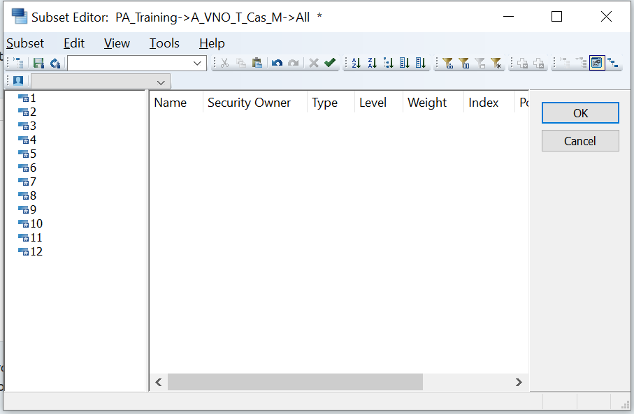

I implemented some of the changes you suggested. I did not change the subset on G_Rada_Filter because it is a flat hierarchy and there are no consolidations. I implemented the ExtractSkip values and DataSOurceType parts. I did not implement the Logging since it is just a practice exercise and it has a tiny size. I will implement the target view to practice, but for now, if I understood it correctly the reason my script does not work is that I did not assign subset for A_VNO_T_Cas? And I need to assign consolidated subset at highest possible hierarchy (total)? If so, how should I proceed if the A_VNO_T_Cas is flat hierarchy also (no consolidations viz picture)?

Either add a consolidation on top of your Cas dimension and implement my original suggestion
Or
Change your CellPutN to CellIncrementN, as you will be getting multiple rows from your data source and you need to add them all together in the target cube

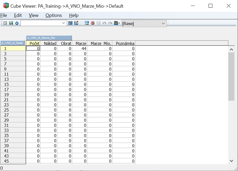

Thanks, I tried CellIncrementN before. It correctly sums the Marze for the the first element of the A_VNO_G_Rada but it leaves the others blank.

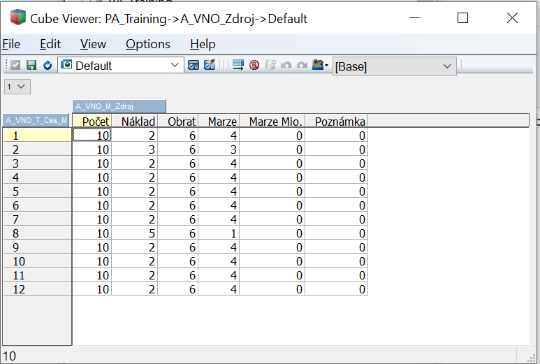

Your screen shot only showed the source dimension in the title area. Is it possible that as Lotsaram says that you only have source data for element 1.
