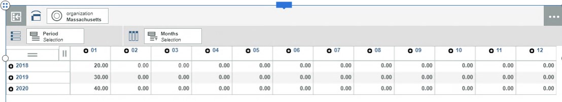

If we cross both hierarchies, input can be done in a grid, even though we only have 1 dimension:
This works fine. Every cell in the grid (36 cells) is each time the result of only 1 valid underlying cell, even though 36 cells are underneath it: 1 combination is valid.

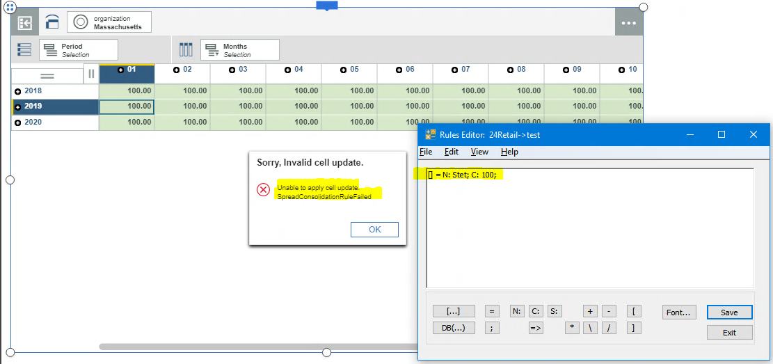

But by choosing this approach, C-level rules are out of the question. We get into a conflict between data input and a rules-calculation:
This means that the user is restricted to a view at level 0, 36 periods in the rows, or in the columns, but not 3*12 or 12*3.

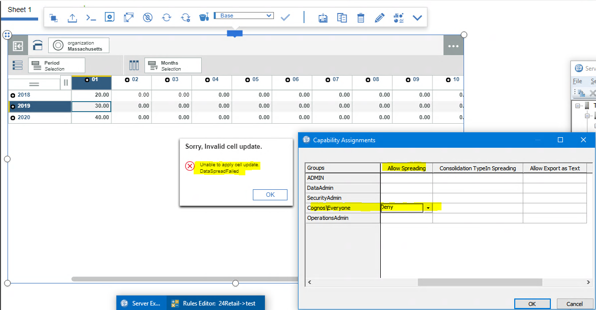

Likewise, prohibiting data spreading is not possible anymore. Once we do that (it's a server-wide setting, the user cannot do data input any more !

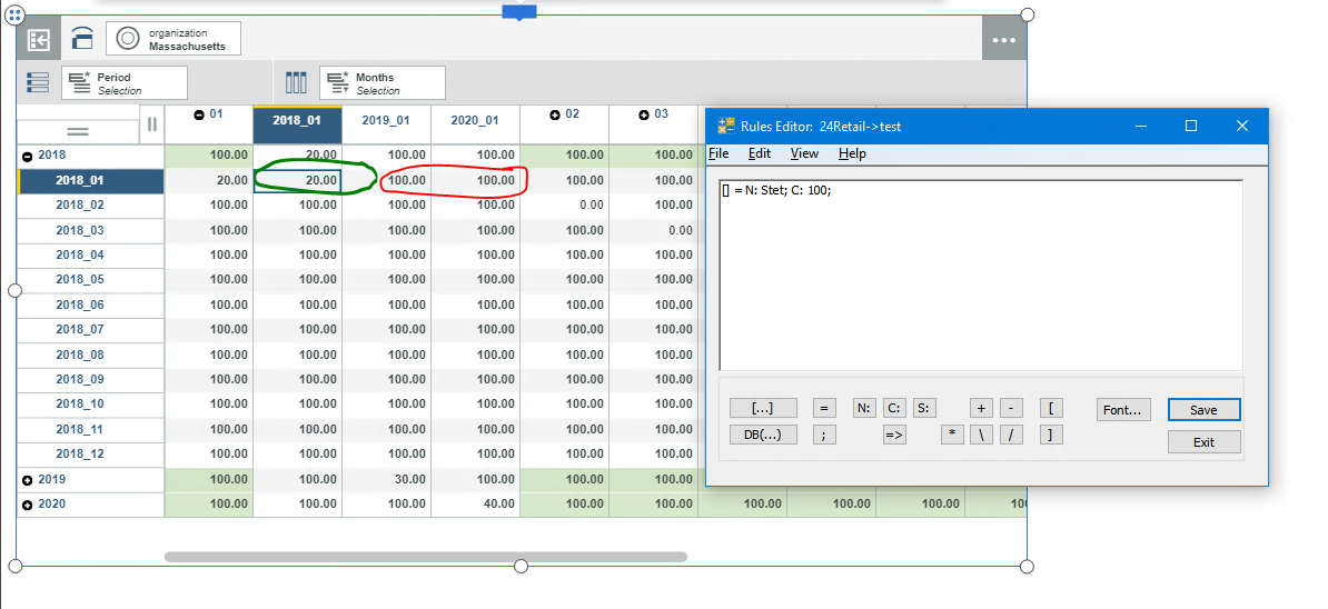

I also find it confusing to see that invalid cells are in fact C-level cells:
The cell in green is a valid cell, open for data entry.
The cells in red are invalid, as the N-level elements they reference, are not equal.
But why would they become consolidated and receive a value of 100 ?
Interesting bug, I've managed to reproduce it. BUT: if you split the N: and C: rules, it works fine :shock:
[] = N: STET;
[] = C: 100;
