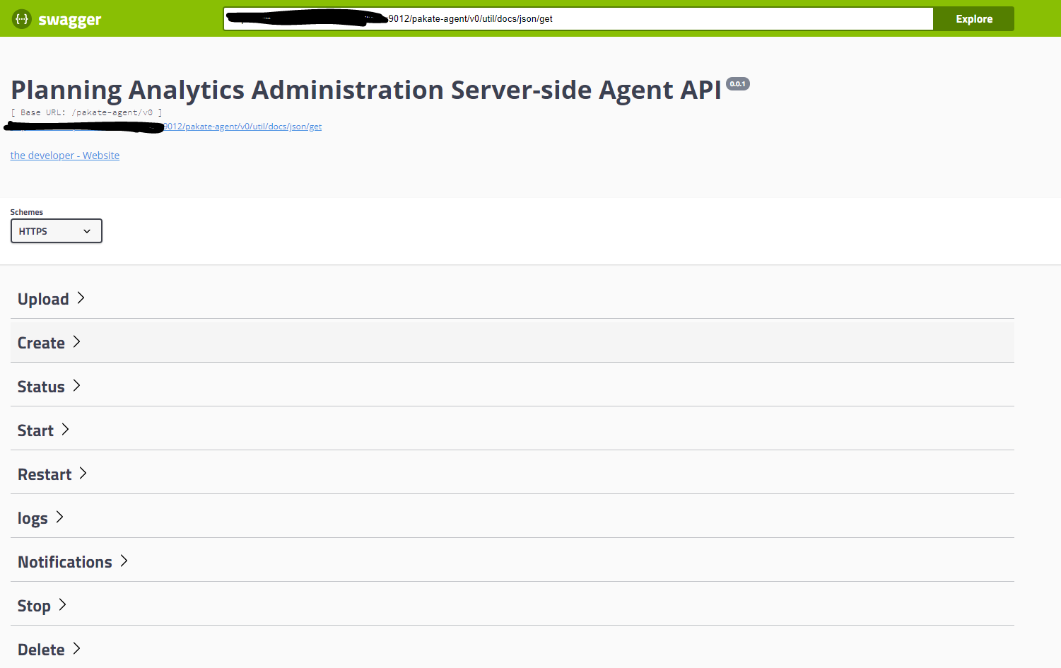

You could try using the Planning Analytics Adminstration Agent API to get some of the information.
https://www.ibm.com/support/knowledgece ... l_paa.html
After installing it just call the api (example: https://localhost:9012/pakate-agent/) on the tm1 server in a browser.

Sure. But don't expect much. A colleague of mine showed me the api.

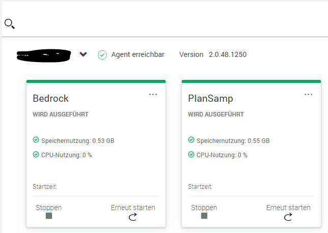

First you have to install the PAW Adminsistration Agent which allows PAW to get the information presented in the new administration window.
Afterwards I think the api was accessible. If not let me know and I will check for some configuration.

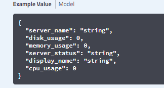

You can do all kind of fancy stuff via that api like creating and restarting and deleting instances and retrieve benchmarks for your instance (i.e. cpu usage, memory).
You can get logfiles, upload files to the server...
Looks very promising. Let me know if that helped.
